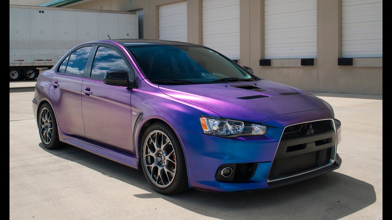

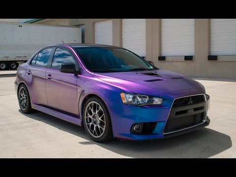

              ​GLOSS PlastiDip

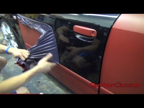

                ​Peeling the PlastiDip
