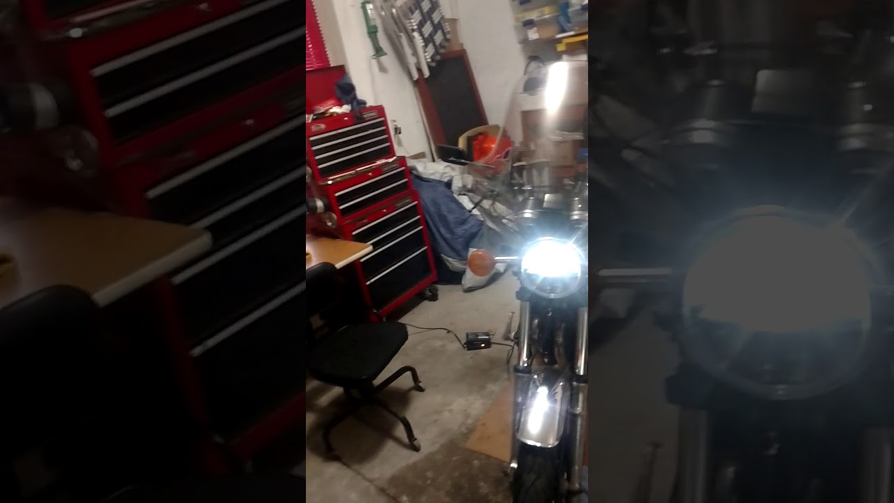

    A few months back I was cruising down the highways on the San Bernardino mountains after a camping trip. The LED headlight I have is powerful, using a projector lens as well as a spreader to try to throw light both far and wide. Up to that point in time, the light has been great.
    However, it got late and the sun set behind the mountains. I noticed in the dense twisties that I couldn't see much until my bike swept the curve, basically forcing me to slow down so I wouldn't outrun my visibility (problematic with people behind you).
    Is this an issue you face with your bikes? Is it a problem with the headlamp itself? I'm thinking to add a small lightbar or something just to make a wider sweep of light, while being careful in its implementation not to blind oncoming drivers. Perhaps you all know of a better solution.

              My 1983 GS850GL with a Trucklite installed and Superbright LEDs 2" work lights (12V) on the lower crash bars - So this is MY EXPERIENCE
              Pay attention to the LOWER driving lights -
              Those are wide beam LEDs (30 degree) that will light up much of the side of the roadways at night -
              AND consequently the wider beam and lower placement will light around the corner -- a little -- better than the Headlamp alone -

                  If you are asking about how well the TruckLite fits, let's just say that it's pretty much a plug-and-play drop-in to replace the stock light.
                  You have to disassemble all the headlight "stuff" that is attached to the chrome trim ring, but it's the same as replacing the stock light. The clear lens of the TruckLite will stick out about 1/2" from the chrome ring, but there are no other issues concerning the fit.
                  My wife's 850L (just one year older than Wingsconsin's) is wearing the same windshield. My son has a 1000G with a Vetter fairing and a TruckLite. My 850G(K) is just a little different, it has a Pacifico AERO fairing and a rectangular TruckLite. No issues with any of them.
