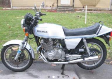

Hello everyone, I am new to the whole motorcycle projects, and I was wondering if I could turn my gs450ga style into the basket case Suzuki 450 style. Is it an easy task? Below is an attached image of what I would like the bike to look like. Would I have to change the frame?

I have two styles T and E in a very similar Suzuki (GSX400). The T is very similar to your GA..though exactly, I don't know but I bet it is very near.
These are the preliminary Must Know notes. I haven't done a "conversion" (wouldn't bother) so I can't guarantee that's all there is to do but:
That's an "E" you picture. Your frame is basically the same but they welded some different tangs on each...me having the two styles, I'll guess your coil mount is different and won't fit the narrower tunnel of the E tank; the rubber ended stems that hold your tank stick out too far for the "E" tank; the E tank needs ONE bolt at the rear; the side covers of the "E" sit on welded "L" tabs at the top while your GA covers have all "tongues-into-rubber grommets" holding the sidecovers?... The frame of the E has provision to bolt on a steel framework to mount the E tail piece.
...Pretty much the same otherwise, though your gauges won't be "correct". The E has a kind of housing and slightly smaller dials in it but that doesn't matter...The shocks of your GA...11.5"? 12"? dunno but 13" on the E. Not that that really matters either. They fit across both models.Last edited by Gorminrider; 03-19-2021, 11:02 AM.

You do realize that after dealing with any title issues, that your GA really is nothing like the E that is pictured?
Exactly what part of the "look" are you wanting to change?
- The tanks are different, not sure about mounting points.
- The engine is different. Well, the pistons and head are basically the same, but the crankcase is different, along with the transmission.
- The final drive is different. Can not be converted.
- The frame is different. Can not be converted.
By the way, the bike in the picture is not a basket case.
A "basket case" is a bike that arrives in a bunch of baskets and needs to be assembled.
Therefore, if you want your bike to look like a basket case, just break out the wrenches and start disassembling.

A 450 that looks like a T with a shaft drive? That seems pretty neat and a bit of a rarity too..AND it's not an L with the big step on the seat. I don't know why you'd change it in the first place.
