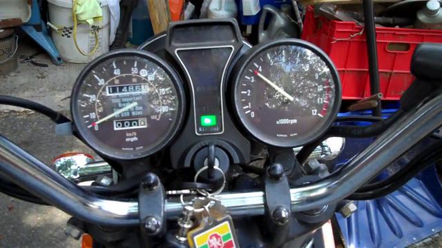

    Hey guys I was hoping some of you had some advice. My bike bogs down when i pull the throttle. I was thinking it had to do with the choke because it only runs when the choke is all the way on and is probably not getting enough air intake for the fuel. Oh and i recently cleaned te carbs. Im gonna adjust the throttle cable tomorrow to see if that helps. Any help is appreciated thanks
    here it is running in this video. 1/2 way through the bike starts running without bogging.
