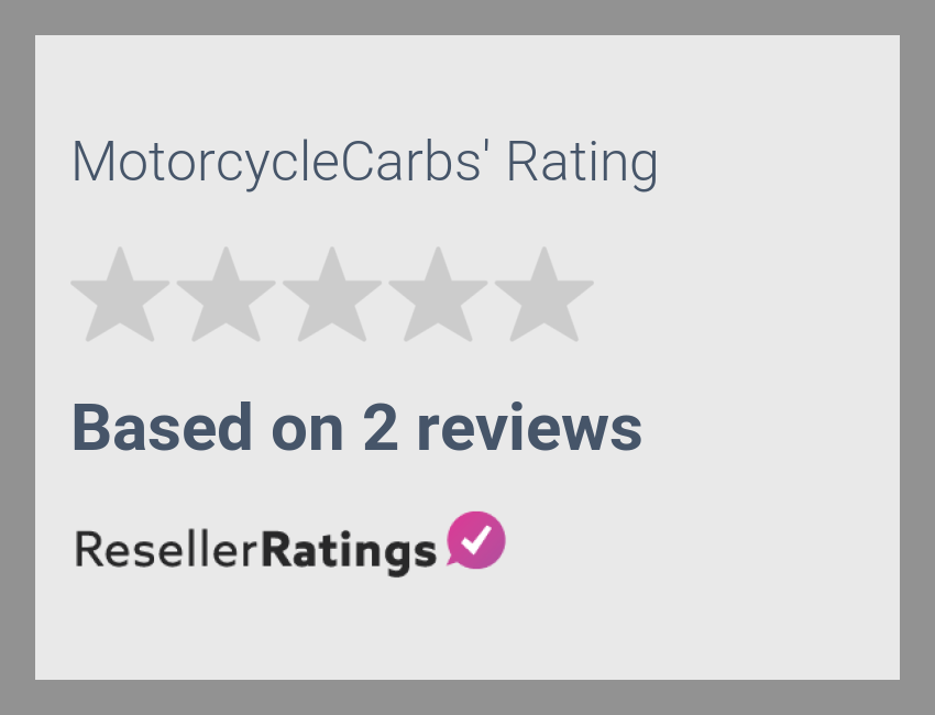

                  I would think twice about dealing with them.

                        Before you consider buying from them with all their bad reviews, you may want to consider what I've been suggesting, and I got both parts in 2 days and didn't cost anymore than the original would have. Also, if I'm not smart enough or too lazy to turn it to the off position, then I deserve a full case full of fuel, the oem is a smart design when funtioning, but I don't like relying on someone else's technology to protect me from myself nor have the possible
                        o-ring failures (which this has none) or the vacuum restrictions, and they do occur, if you've ever looked at the vacuum restricter in the petcock, they can and do get clogged, very small holes I'm assuming to aid in increased vacuum to overcome the spring tension. I know, famous last words when my case fills with fuel, but I prefer the outcome in my hands.
