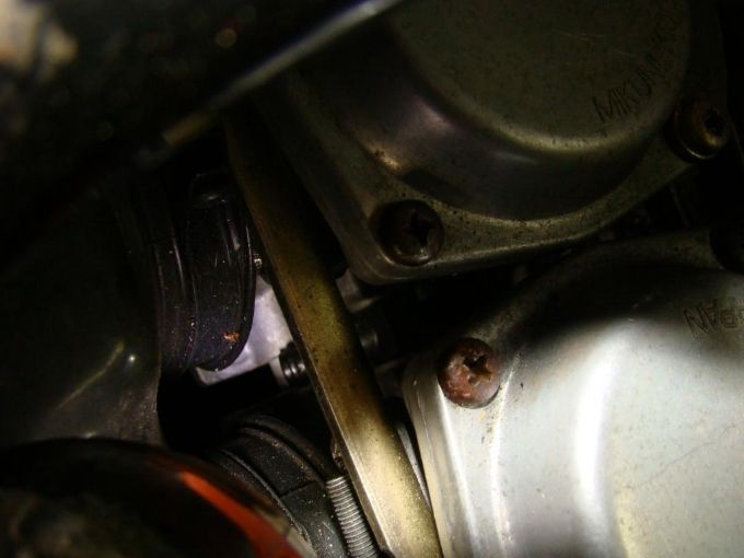

      This is what it looks like. I might need to drill it out to get the T-vent to fit in there.
      This is what it looks like when originally attached to the ganged carbs.
      What do you think?
        Something does not look right there, but I cannot put my finger on it. Do not drill anything, yet. Let me have a look at my carbs to see what is up.

                That individual carb just looks wrong for the bike. It looks like a cast nipple where the removable tee should go.
                I couldn't get a decent shot with the P&S camera...but you can see the fuel tee (sans vent line) here:
                '83 GS650G
                  The thing is man is everything else checks out perfectly! The only thing is that vent nipple. I will just bore it out with a drill press and make sure the fitting goes in there. Shouldn't be a big problem. I've already had many issues with this damn #4 carb.
