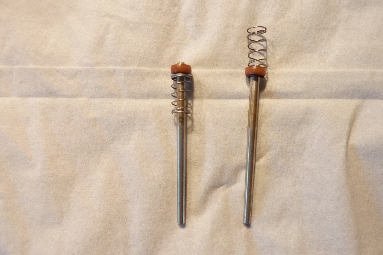

If after the engine is warm and idling without the choke and you have no throttle response like this:
Then it's no fuel coming through the main jets. Most likely float heights wrong or (as was in my case) the main jet needle assembly was put together incorrectly (my fault). This is what I did wrong:
Left side is correct!
