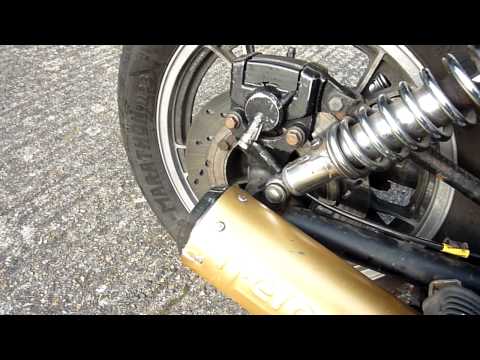

            Ive owned the bike for 3 years now. Im not sure how many miles it has because the previous owner replaced the electronic cluster with just a small circular speedometer which read 1000 miles. It has the stock exhaust, stock air box, and dual mikuni carbs. When I first got it, it was running fine I rode it quite a bit. Then it spent a year outside because I lost the keys and thus I thought the bike was a lost cause because a new key was $300+, which was pretty dumb of me. About 7 months ago I realized I could just hot wire it and ride it anyway, so I wired in a toggle switch and have been using it like that since. Then i found out the ignition switch assembly with a new key was only $45, oh well.
            Ever since I started riding it again after sitting for a year it's been smoking. What I mean by it never smokes when it starts is, only after about 10-15 minutes of riding does the smoke appear. After starting the bike for the first time in the morning, its just fine. If I ride it for a while then turn it off and give it a small break for a few minutes or so the smoke isn't there when I start it up again. It used to only smoke out of the right tailpipe, but as of this morning it seems to smoke out of both, yet more out of the right than left - the only thing I've changed was the float height. There is also a small bit of wispy smoke when i open up the oil fill cap on the right side of the bike.
            Ive chemically stripped the whole gas tank, got a new petcock, and changed the air filter and spark plugs. One of the choke plungers was missing a spring so I replaced that with something close to the original size from OSH. I've cleaned the carbs and had them synced at a shop. One shop I took it to said they were sure it needed the valve seals replaced and another said it was just dumping too much gas in. Ive done compression tests and got around 110 to 120. I got a clymer manual but that seems useless unless I can figure out whats causing the smoke.
            Here are some videos I took this morning
              Check to see if the oil smells like gas. If it does, then you may have a leaking float valve. You may also want to check the carb sync. Several have noted smoke until the sync was completed correctly.
              If that's all the smoke you're getting and the oil smells OK and you done the sync, then ride it.
