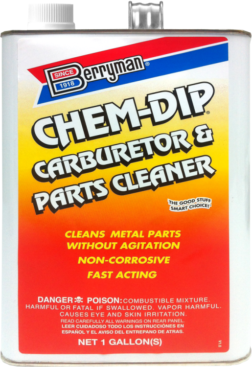

Berrymans Professional is part # 0901.. its a square metal 1 gallon can and you will only find it at an old fashioned parts store NOT autozone or advance etc.. try an old mom and pop auto parts store. Compared to the 'regular' berrymans it works MUCH better..
If you can't find that, you can get the 5 gallon but its $140 and is part #0905.
The "regular" stuff seen in walmart etc is part #0996 and works but not too good anymore IMHO
http://www.berrymanproducts.com/products/carb-and-parts-cleaner/berryman-chem-dip-professional-parts-cleaner/
