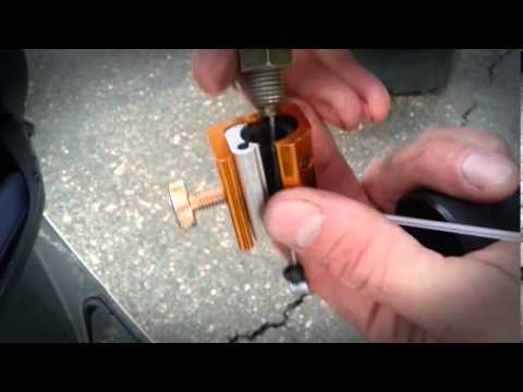

    Are you sure it's the carbs and not sticky cables?

          You say "no issue after servicing the carburretor" . How did you service the carbs w/o touching the cables??
