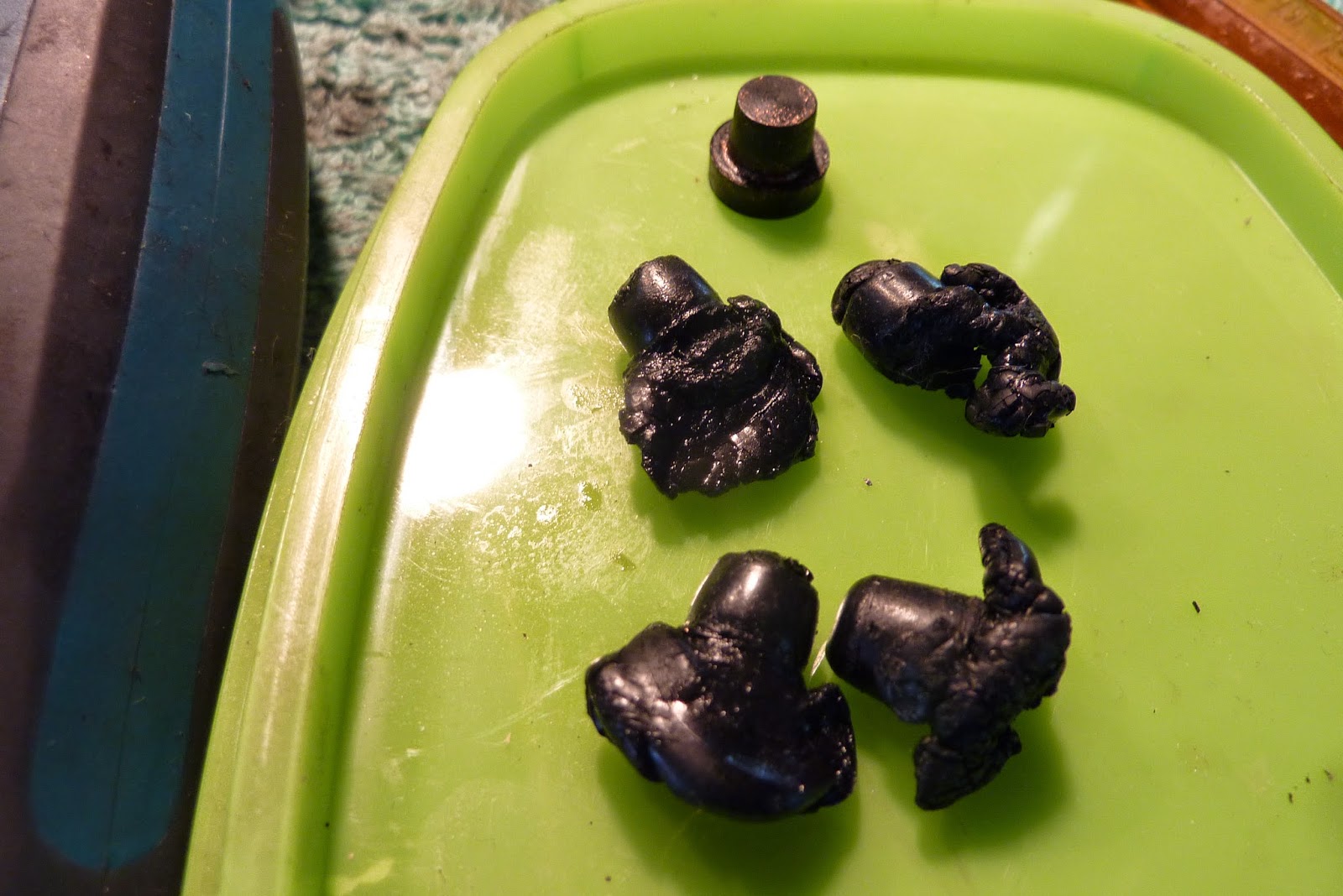

      Yes they should be squishy enough not to fall out but not like this:

        Those plugs are held up by a riser in the bowl which presses them up into the tube. They don't need to fit perfect because they will get squished into place when you fasten the bowl.
          That's the answers I was looking for ...with pics too ...awesome ! I don't think I need new ones now , Thanks to all for your help !
            Yeah those are trashed big time, new ones needed for sure. Those look like they have been sitting in Berrymans for weeks.

              Those ones in the pic above were "new" from some eBay seller and were only installed for 9 months before they turned to mush.
              I'm guessing it's the crap fuel we have these days.
              Beware non-OEM!!
