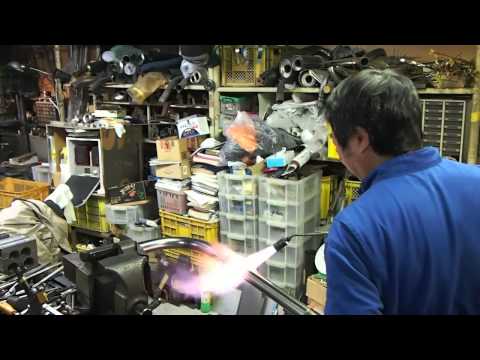

    Yup..a Rosebud and a set gauge to set all the bends the same. Send it to chromers when done.

      I think that's stainless steel tubing.

          The article doesn't say, at least not in English, but the end of the pipe is capped off while he's bending it. I think he's using the technique of filling the pipe with sand, packing it in, and capping it off before you bend anything. This keeps the pipe from collapsing or kinking at the curve. My dad told me about it but I've never seen it done before.

              I noticed the tube was taped closed on the end, I wonder if it was full of sand to help maintain roundness of the tube?

                  I did some stock car racing 35 years ago and a fellow I knew bent tubes that way, doesn't take much to bold the sand in cause it doesn't exert force,, when done right.

                    That's an expensive acetylene bill to do that!
                    I watched a guy on YouTube make headers, he filled the pipes with water, froze them then used a hydraulic pipe bender to bend. It only had a small crush in it then he fixed that. Way more economical than the torch method, if you even have a torch setup like that.

                      One thing I noticed is the flame was not very hot. Carbonizing flame I think is what that's called. It had to be filled with sand or similar so it wouldn't kink. Another thing I noticed is that he only heated the outside of the curve actually stretching the metal on the outside to lesson the kink. Definitely an artist at work. Thank you for posting.
                      While I have a vise and an oxyacetylene torch with a rose bud, no way would I try this. I'll leave that to the pros.

                        Meh, the pros learned by trying it a few times and practicing it. I'd like to try it out, I could sure use a few good pipes. If it doesn't pan out there's nothing wasted but time, some pipe and a bit of gas.

                          When the pipe first started to bend, I couldn't figure out how at first. It took me a while to notice he was pushing it with his hip.
