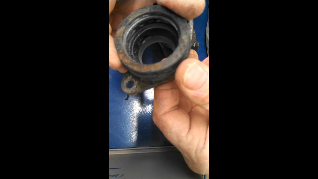

Could be alot of things. I always suspect worn carb boots or boot o-rings when I hear the idle is erratic ( possible vacuum leakage). Probably need to rebuild carbs as well if you haven't done so and definitely sync them

the carbs were rebuilt the summer i got it. it had to be done in order to get it to run. so the gasket, o rings, and jets are less than 2 years old. i also inspected the boots a few days ago while i was replacing the valve cover gasket and didnt find any tears or leaks. there was a tear in one that i patched with some high heat silicon, but it seems to be holding fine.
