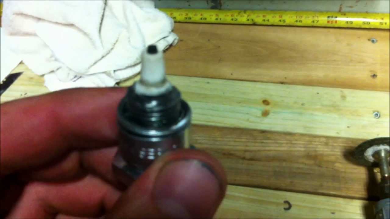

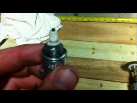

    Here are the plugs...
    They are just barely starting to get any color.
    Was it not a long enough run? Or is it really that lean? Any advice? Go easy on me...

    I've never seen a plug like that. What did you do to them?! But yes, they look like brand new plugs to me.
    What do you mean you did one chop on cylinder 4 and a second chop on cylinder 1??

      I just chopped the threads to see the base of the porcelain. The first run I did was with a new plug on cylinder 4. The second run I did a few weeks later I tried it on cylinder 1 instead.

        LOL, nice troll!

            Looks like he literally "chopped" them.

                Ha, I get it. Looks like I just "chopped" brand new plugs and was asking why it didn't work.

                  I think leaving the plug intact would give more surface to evaluate the condition. And studying all four cylinders would be good too.

                      The rest of the plug looks almost brand new as well.

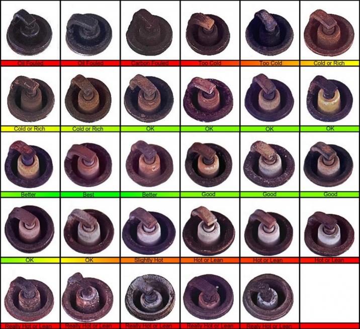

                      I was going off of all of this information...

                          Seems like I was mistaken. I've never seen photos of plugs actually cut. I thought "chop" meant cutting the power to the engine at WOT.
