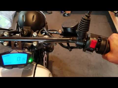

    Was wondering if anyone has dealt with this before as I'm not seeming to make much progress. The bike will rev well when given 1/4 turn or more of throttle, but when slowly rev'd or the throttle is held at low RPMs it will start to stumble. To me this sounds like it's going rich. With the current filter/exhaust set-up I would think I'd have to bump up the pilot jets a notch or two from the 17.5 stock set. In reading Pete's GS450 build that's similar to mine it sounded like he was just fine with the stock 17.5 set yet others report success with pilot jets in the 40's. I've been trying three different pilot jets from 17.5 to 22.5 as well as float height adjustments and mix screw settings but can't seem to get rid of the partial throttle stumble. Starting to wonder if it's something else, or perhaps I need to get some pilots in the 40's? Lots of details and a video below if anyone has any suggestions on where to go from here.
    Current Settings:
    Mixture screw - 2.25 turns out
    Pilot jet - 20
    Float height - 23.5 mm
    Jet needle - plastic spacer removed, one 0.5 mm washer in its place
    Main jet - 145.2
    Notes - Still stumbling... see video.
    Bike specs:
    1981 GS450L
    13,500 miles
    Filters - K&N ovals with Outerwears pre-filters
    Exhaust - MAC 2-1 with shorty muffler
    Carbs - BS34SS; 24 hr chem dip; hex bolts; balanced; new o-rings including intake boots.
    Settings Tried:
    Mixture screw - 3.25 turns out
    Pilot jet - 17.5 (stock)
    Main jet - 145.2
    Notes - Bad at small throttle openings, dies quick when given any throttle.
    Mixture screw - 2 turns out
    Pilot jet - 20
    Float height - 26.3 mm
    Main jet - 145.2
    Notes - Much better at low throttle, not dying. Still a bit of rev hang (lean) so turning mix screw out.
    Mixture screw - 3.75 turns out
    Pilot jet - 20
    Main jet - 145.2
    Notes - Best setting so far, idles at 1200. No rev hang. Still partial throttle stumble.
    Pilot jet - 20
    Main jet - 145.2
    Notes - Idling well, still stumbling at part throttle. Perhaps slightly worse than previous settings.
    Pilot jet - 20
    Main jet - 145.2
    Notes - Maybe slightly better on part throttle, hard to tell.
    Pilot jet - 20
    Main jet - 145.2

        Thank you Chuck and Pete for your thoughts; I greatly appreciate it. I have some success to share with you.
        I've broken down the carbs again tonight after work and gone through everything again. Per each of your thoughts I focused on the slide/jet needle/diaphragm parts. The diaphragms showed no holes when backlit. The slides were buttery smooth upon lifting and dropping and lifted when presented with air. The jet needles were genuine Mikuni non-adjustable 4C2's (somewhat unfortunately) and showing no wear.
        The issue was completely my fault and ended up being the C clips in the slides not being seated correctly. I thought I had gotten them below the ridges but they were slightly above. This caused the jet needles to be too high up which was flooding the carbs with gas at partial throttle when the transition off the idle circuit was occurring.
        I'm happy to report that the low throttle stumble is gone and I took the bike on the longest ride I've ever had with it (which was about 1 mile.) It seemed to be a hair lean, with a little rev hang when blipped, but I am happy to have a base I can work with.
