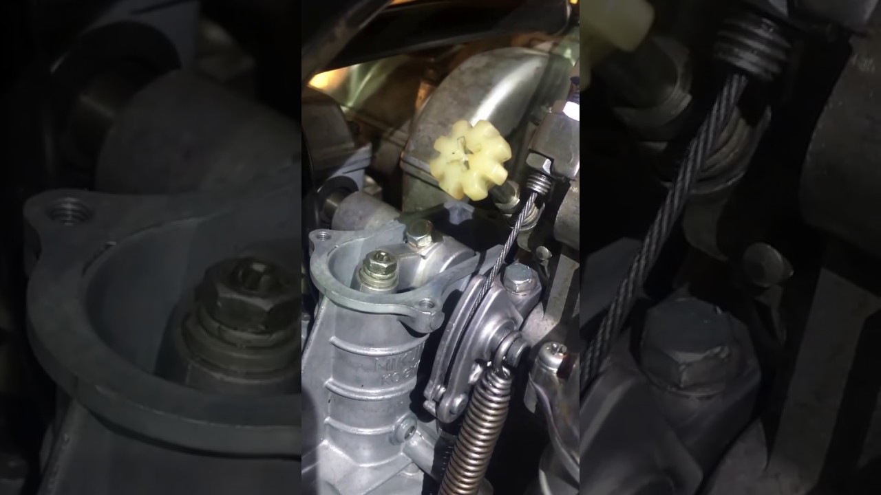

For reference, this is a video how the idle manifests (Apologies if you have seen this in other threads, embedding it here once again to keep the thread consistent):

The reason why I took the boots from the airbox was the last time I sprayed starter fluid around the area of #2/#3, the RPM changed - slightly, but it did. After a lengthy vaseline bath, I had quite some trouble to put them back in, and they didn't swell much, if at all (I have yet to acquire xylene/wintergreen). I beginning to doubt that they're leaking, pending further investigation.
