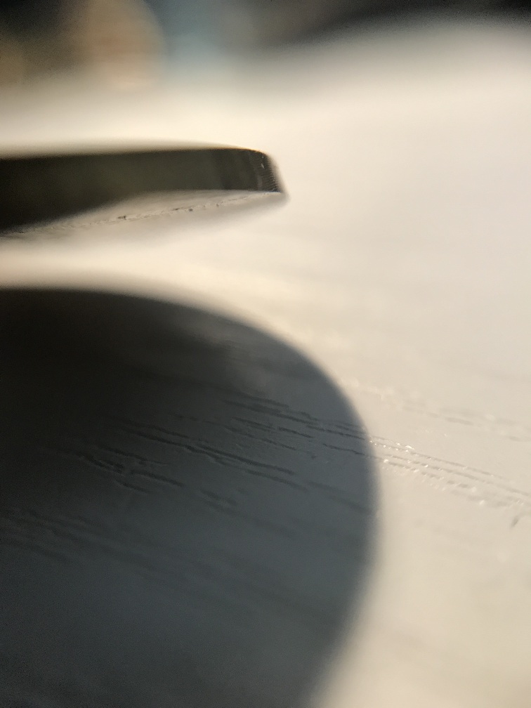

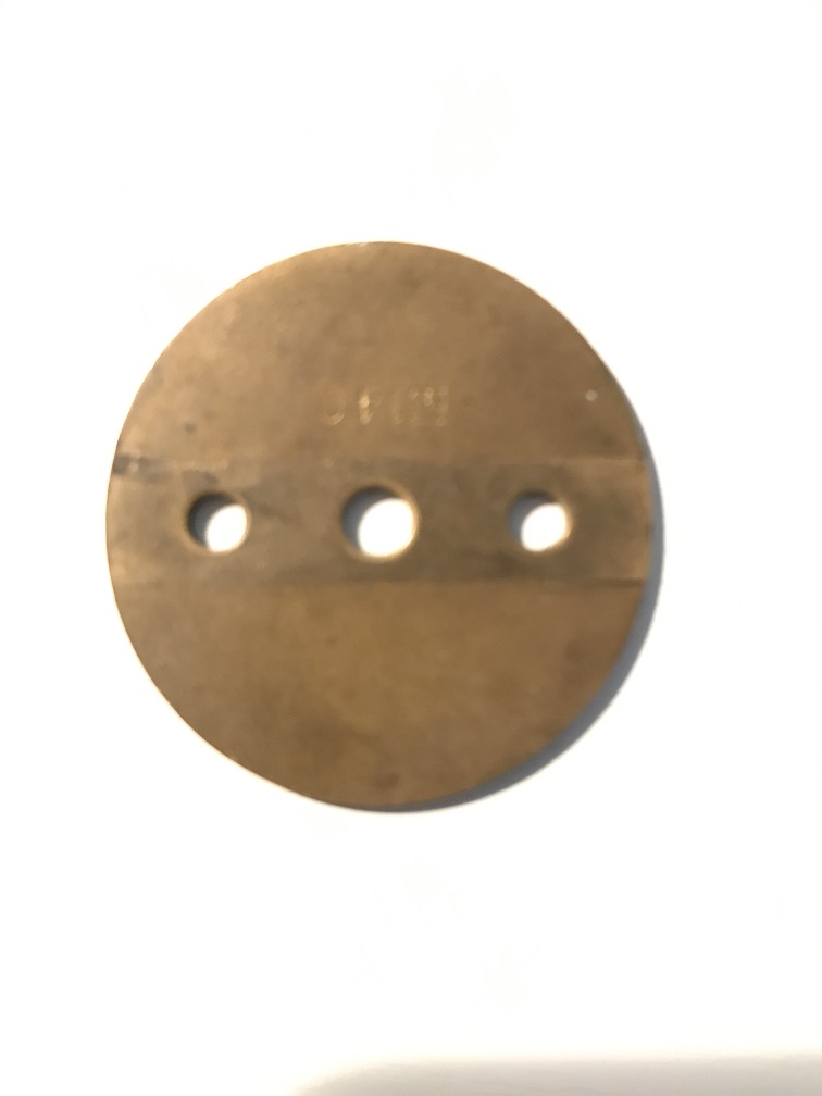

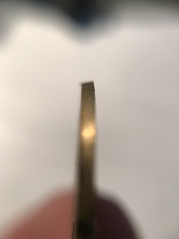

                        Here's something about the butterflies; the number stamped on them refers to the cut of the sealing surface. The butterfly valves are sort of egg shaped and they need to completely close a perfectly round hole. They do this by being fully closed at about 3 degrees off horizontal. The edge of the valve is champhered in order to effect the seal.
                        Now if the butterfly was changed and placed into a carb body in which the champher did not match the internal bore of the carburettor, then that butterfly would not close properly. That could be one issue. I would test this by removing the plug on cylinder 3 and seeing if you get the same high idle. Obviously on 3 cylinders it will not idle as well but I'm sure you would be able to tell if it had the same urge to spin higher.
                        Then the other thing to check is that the carb no.3 that you say was changed over has the same internal diameter at the engine end and that it is jetted the same as the other carbs and that the float height is correct.

                          So now we know! But I'm not clear on what you mean by "cut of the sealing surface". Does the number refer to the angle at which the chamfer is cut? And knowing this, would you expect a valve that is stamped "135" to be fully compatible with three others that are stamped "130"?
                          I did notice when I had the idle adjustment screw backed out far enough to be disengaged from the adjuster on the #3 carb, that the valves kind of got "sticky" when they were fully closed. Could the one "135" valve cause this?
