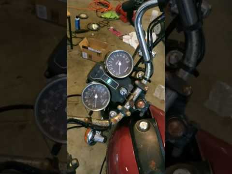

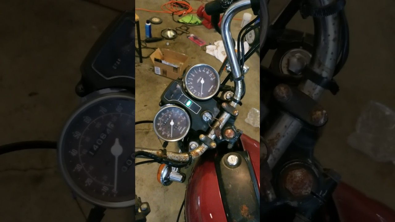

                      • Bkan
                        Here's a video of it running. Not really sure how, but it sat at normal idle speed. Usually it'll sit there, and then ramp up and down. Maybe since today was cold and rainy? Its 50f outside and when I usually try it its around 85.
                        The reason it stays revved is because I unscrewed the throttle from the handle bar. Normally it returns back to close quickly on it's own. But as you can see, a lot of smoke, especially on the right side.
