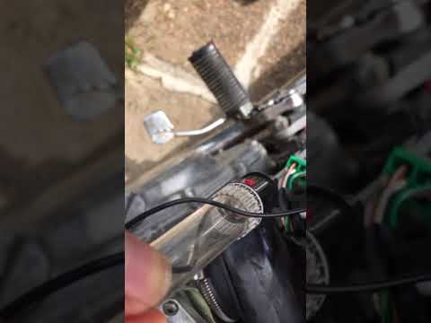

                            Sound like an ignition issue? This is the last video i recorded after bike ran for about a half hour and shut off a few times, mixture screws set at 3.5 turns i believe. Bike didnt sound this bad in the previous vids it broke up a few times but came back before shutting off but in this vid its easily missing. Dont mind the test light was hoping i would get a slower pulse when missing but not sure how effective this was.

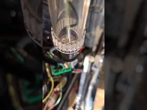

                              this is one video before the last one i posted where bike ran better with some breaking up around idle but doesnt sound as bad as the last one. Bike shuts off at the 1:47 mark you can hear the breaking up a few seconds before, i start it right back up and it runs till about 3:20 also breaking up a little before. not sure if in this video plugs got fouled or if ignition just got hotter and caused it to totally misfire in the other video or if its just a bad ignition system im dealing with here

                                Sure behaves like ignition dropoff....can't see a new dyna failing this way. How about the wire running from dyna up to 1 and 4 coil, any chance that it's pinched or grounding out along path somehow when bike gets hot?
