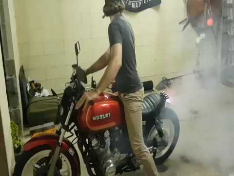

                    IMG_20171231_122140_213.jpganother pic
                      20170830_161426.jpgthe front end

                              so got the gsx750 29mm flat slides working thing goes heaps better .
