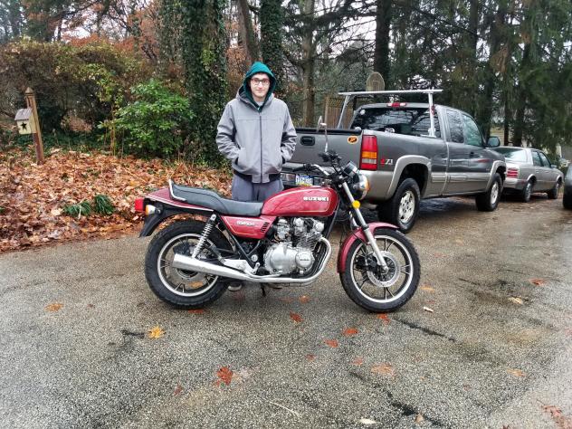

    My son just purchased his first street bike, 1982 650G. Carbs were replaced by previous owner due to broken post for float. Bike will not rev out past 7k rpm. Runs great at low rpm and has nice steady idle. Plugs are definatly fouled from rich jetting. Cleaned and reoiled the uni air filter. Carb boots are connect and new intake boot orings installed. What is stock jetting for this bike? It has stock exhaust and airbox assembly. Has just under 4k miles.

          Tell your son congratulations on the bike. Looks nice!
