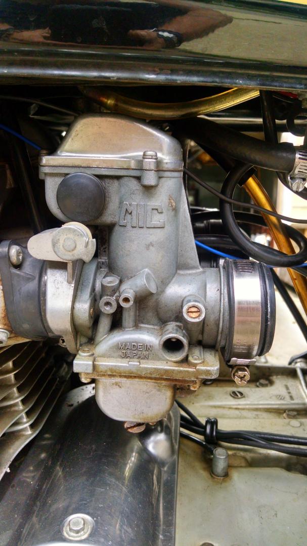

Post up a pic of your carbs for starters
VM 29 float bowl held on by one large but
VM 26 float bowl has 4 screws and a brass drain bolt1978 GS 1000 (since new)
VM 26 float bowl has 4 screws and a brass drain boltAttached Files

Originally posted by RandyRex View PostThese are my carbs, 26s? I have the 4 screws ...

Originally posted by Steve View PostYep, those are stock VM26 carbs.
Stock jetting includes #15 pilot fuel and 102.5 mains. With pods installed, a 115 might work fine, but plug checks will need to be done. Might also need to raise the needle one notch to ease the transition to mid-range.
