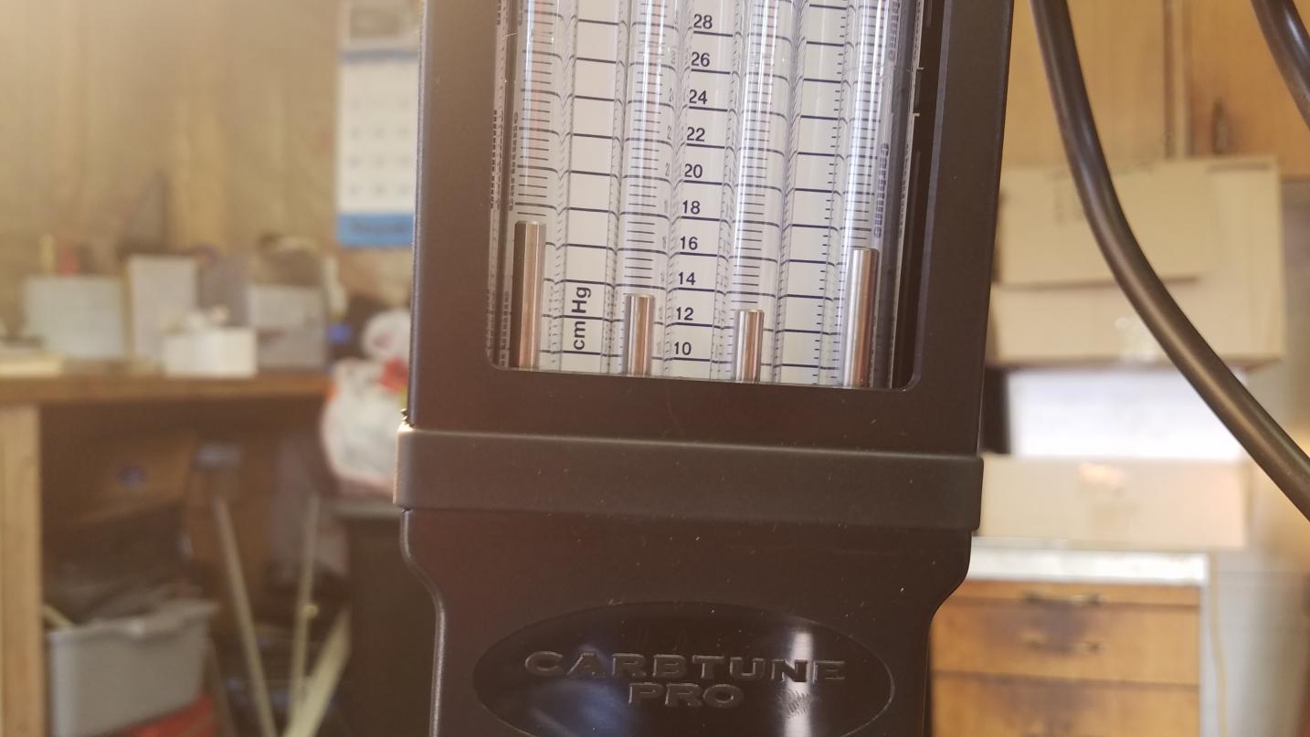

    Ok...I set the idle mixture screws at 2-3/4 turns out from seated and just did a carb sync at 1800rpm. All I did was adjust #1 to achieve what's pictured as it was the only one out of whack. Is this sufficient? I do have the exhaust crossover so this is my understanding as to how it should look? Thanks, again my 1st carb sync...and 2-3/4 turns out ok? Seems to be running very smoothly to me.

      All four should be as close to even as possible; remember though you aren't adjusting the idle mixture screws but the balance screws (has a lock nut on it) between the carbs (there are three of them).
        The pattern looks good, according to the manual, but the difference is too big.
        Of course, there is no way to really tell, because the Suzuki gauge shown in the manual uses balls to show vacuum level and has no numbers. They show a difference of about half a ball, but nobody knew how much difference "half a ball" is. Until I did some experimenting.
        By playing with a Suzuki ball gauge, my Carbtune, a Motion Pro (blue liquid) and my mercury sticks, I was able to show that "half a ball" is 2cm Hg. Your picture shows a difference of 4cm Hg, so I would adjust that. Your 2/3 sync looks good, you should only need to adjust 1/2 and 3/4.

          Excellent feed back Steve, I couldnt have asked for such thorough info. I am a little confused though when you say that 2/3 is good but I need to adjust 1/2 and 3/4. Dont I just fiddle with #1 and bring it down to within 2cm Hg of 2/3 then again with #4 to within 2cm Hg of 2/3? Am I saying the same thing your describing in simpler terms?

            The "2/3" refers to the sync from carb 2 to carb 3. Those are the same on the gauge, so don't change them.
            Adjust the screw between carb 1 and carb 2 to bring them to the same level, or at least have #1 no more than 2cm higher than #2.
            Do the same with the 3/4 sync.
            I never have understood why they called for different vacuum levels. Most of us adjust them all the same, just like we did before we saw that instruction in the service manual. The cylinders with a lower vacuum level have that lower level because the throttles are open just a little bit more. That means that they will be producing just a little bit more power. Since that is at the very low power of idle speeds, it's not going to twist the crank, but I still like even power production when possible.
