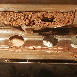

    So my carb re-build is complete. Thanks for the forum help on initial tune up. I just feel like putting on my corroded airbox with it's obvious gaps between filter and the sound of an eggcup full of rust rattling around in the top which appears to be unshakable, is a fools errand so...
    Is there a viable cone alternative that won't need re-jetting? Should I re-jet because it's just better? or open up the airbox, weld, repaint and re-use?

    I've taken some pics but they're not uploading: Had to do surgery with a view to tack weld and seal after as a temp fix after a good jollop of galvafroid. How did it get so rusty? It's like its been underwater! And sorry to be naive but why the separate box for the breather and how does that link to the main intake box? You'll see that i cut a baffle from the top to bottom where the pipe sticks through. Is this about atmospherics or heat or what? Anyhow, just another day in the garage...

    “I want to cone it really “
    Then have a go at pods.....bunch of members here have done it with the VM setup.
    Probably easiest to fix your air box..or get decent used one....be less work to get it running properly , before you make the pod leap.
      Going to have to patch her up hehe but why the breather in its own tank? See hose, there was a plate there too corroded to comprehend why?
