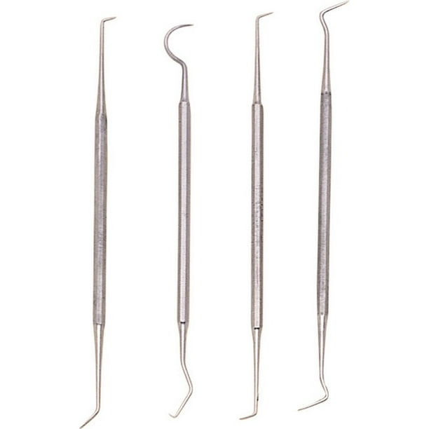

                  Might want to look for a dental pick set like this one at Walmart:
                  Quite handy when working on carb orings too.

                    That was my other option, I'm just worried that they are flimsier and could break.
