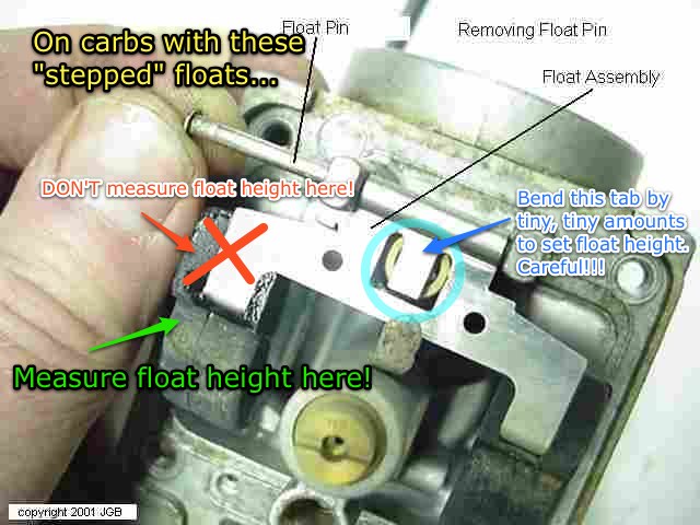

When measuring float height on the BS32 carbs are you supposed to measure to the very top of the float or just before the hump? One set of instructions I found on here shows before the hump. Every where else says the very top. Which one is correct??Current Bikes:

Originally posted by nutz4spd View PostWhen measuring float height on the BS32 carbs are you supposed to measure to the very top of the float or just before the hump? One set of instructions I found on here shows before the hump. Every where else says the very top. Which one is correct??Ed
Edit: Picture courtesy of member Nessism from his excellent tutorial.Last edited by 2BRacing; 05-19-2021, 03:32 PM.1981 GS850G "Blue Magic" (Bike Of The Month April 2009)
Well then...I'm officially ignorant. I've been measuring to the very top of the float. Yet the bike still runs well (somehow) minus some surging at cruising speed. Looks like I need to go back and reset them. Again... Live and learn. Thank you for the clarification.Current Bikes:

A large percentage of BS carbs I encounter have the float levels set to the top instead of the step.
The bike will run, but it will run like poop.
As Ness stated, this is very clearly described and depicted in the manuals, so I don't know why this happens so often. Reading are hard, I guess.
