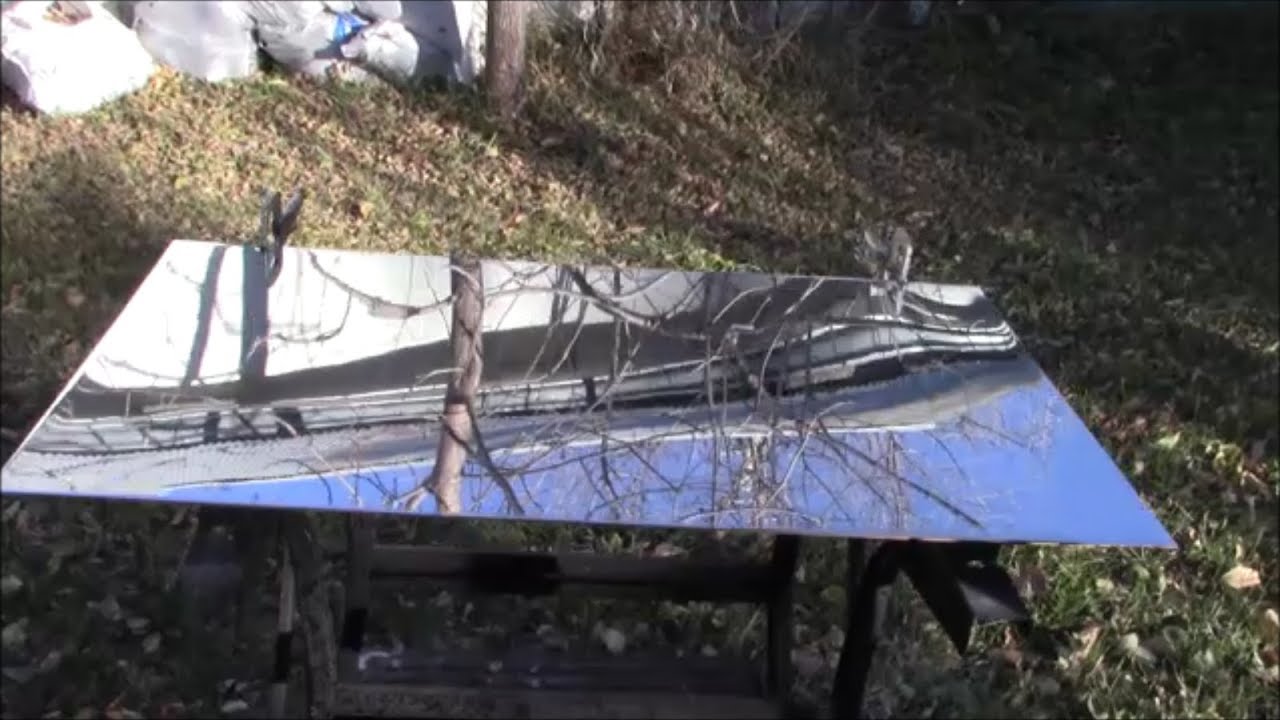

Does it contain lead or some other substance?
How reactive is pure zinc? Not sure what this guy is polishing but it buffs up mirrorish

Yeah well soon as i find a microscopic sander that may be an option.MY BIKES..1977 GS 750 B, 1978 GS 1000 C (X2)
