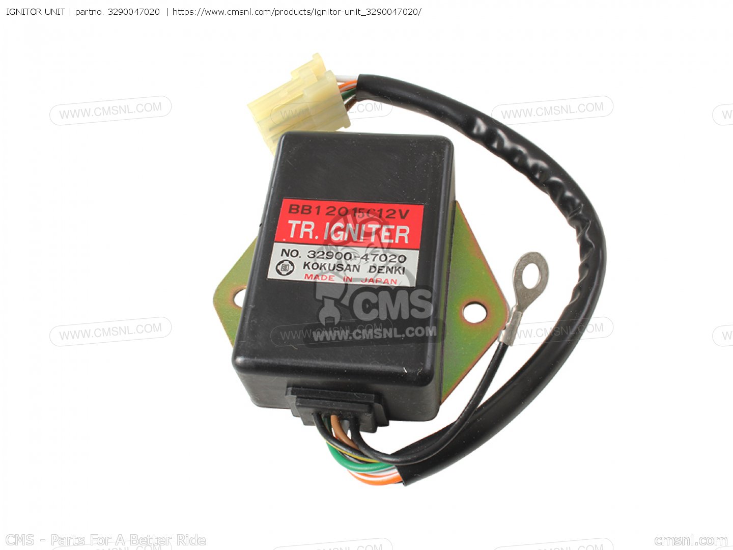

I think the 250 uses the same ignitor as the GS450 and (twin) GSX400. You can cross reference part numbers here:
✓ Good to order: CDI UNIT KOKUSAN ✓ Manufacturercode: 32900-47020 ✓ OEM Suzuki part
