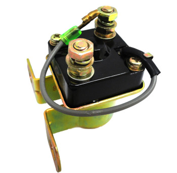

    Has anyone found any acceptable replacement starter relays for the '79 GS750Es?

    This is the standard starter relay everyone uses for those bikes. They are really simple devices, and if you can take them apart, cleaning and sanding of the contacts will fix them. This particular one is around $15 bucks.

        I run a Cole Hersey 12v continuous duty relay as shown in the picture. I run these because of past experience with them.
        It pretty much plug and play.

              The relay is nothing special. You can get it almost anywhere: Hardware store/Lowe's/Home depot in the lawn mower parts isle/ Tractor Supply / Amazon. It just has to have a plate for mounting(this is it's ground, so make it good/clean it up), two posts on top (1 to batt+, one to starter motor lug), and a signal wire to connect to the wire coming from the start button on the right hand control.

                          Just FYI, one common reason the solenoid on a GS doesn't work is because it's grounded to a metal plate that's rubber mounted on most models. There's a black/white ground wire from the harness to the plate, but over the years this often gets overlooked or damaged.
