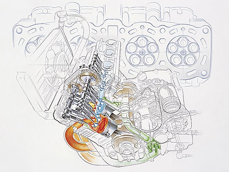

                  Interesting you mentioned the FZR750 Yamaha. That head is one of the very worst I've ever come across for getting the charge burned. Not helped by the factory tolerances on the squish band meaning it's usually around 1.5mm clearance. The OW01 ignition has two advance peaks - 42 deg around 6500 rpm and 48 deg around 8500 to about 11000rpm where it drops to 30 deg. Presumably a rev limiter.
                  When the Loctite Yamaha team came here for the WSB rounds, I watched the team manager - Steve Parrish - blending fuel. Roughly 50/50 organiser supplied 100 octane and local 91 bought from the service station across the road from Manfield. I got talking to him as you do and told him I was aware of the poor combustion chamber shape and had a fair idea of why he was doing the blend - basically to speed up combustion and raise it's temperature for more complete combustion. He just laughed and said the dyno told them to do it.

                    The 5-valve Yamana Genesis engines were a bit a problem child. Cylinder filling was maximized to the detriment of combustion efficiency by virtually non-existent squish in the early engines and marginally more in later iterations. Kevin Cameron described them as follows:
                    "In practice, the five-valve FZR750 of 1985 experienced slow combustion; it needed quite early ignition timing of 45 degrees BTDC. Tuners noticed that this engine could be built either to accelerate or to deliver top-end, but not both. Strong acceleration requires high compression, but preventing knock may call for “squish”: areas of the piston crown which come very close to matching areas of the head at TDC. As such areas come together, with a typical clearance of 0.7mm, the mixture between them is rapidly “squished” out, creating jets that give the air-fuel charge a last-moment stir, helping accelerate combustion.
                    There was clearly some difference of opinion within Yamaha at the time they hired Valentino Rossi to ride their M1 MotoGP bike for the 2004 season. Masao Furusawa, the engineer assigned to provide the best possible ride for Rossi, had four bikes built for Vale to test; two with five valves, two with four valves, two with a flat (180-degree) crankshaft, and two with a crossplane (90-degree) crankshaft. Rossi liked best and went quickest on the four-valve/90-degree combo, so that’s how future M1s were built.
                    Later, Yamaha’s 1,000cc R1 production bike also switched from five to four valves, a design which continues to this day....
                    When Eddie Lawson won the 1993 Daytona 200 on a five-valve Yamaha, its valves had been relocated radially inward by clever welding and re-machining to form a tighter cluster around the central spark plug, possibly resulting in a faster-burning combustion chamber."
