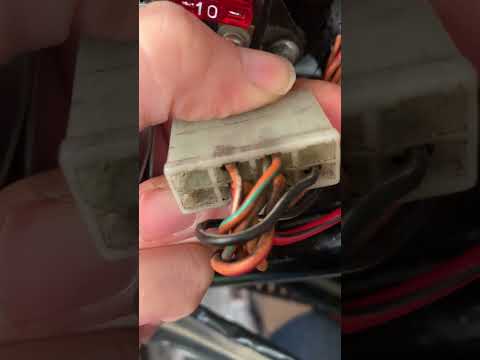

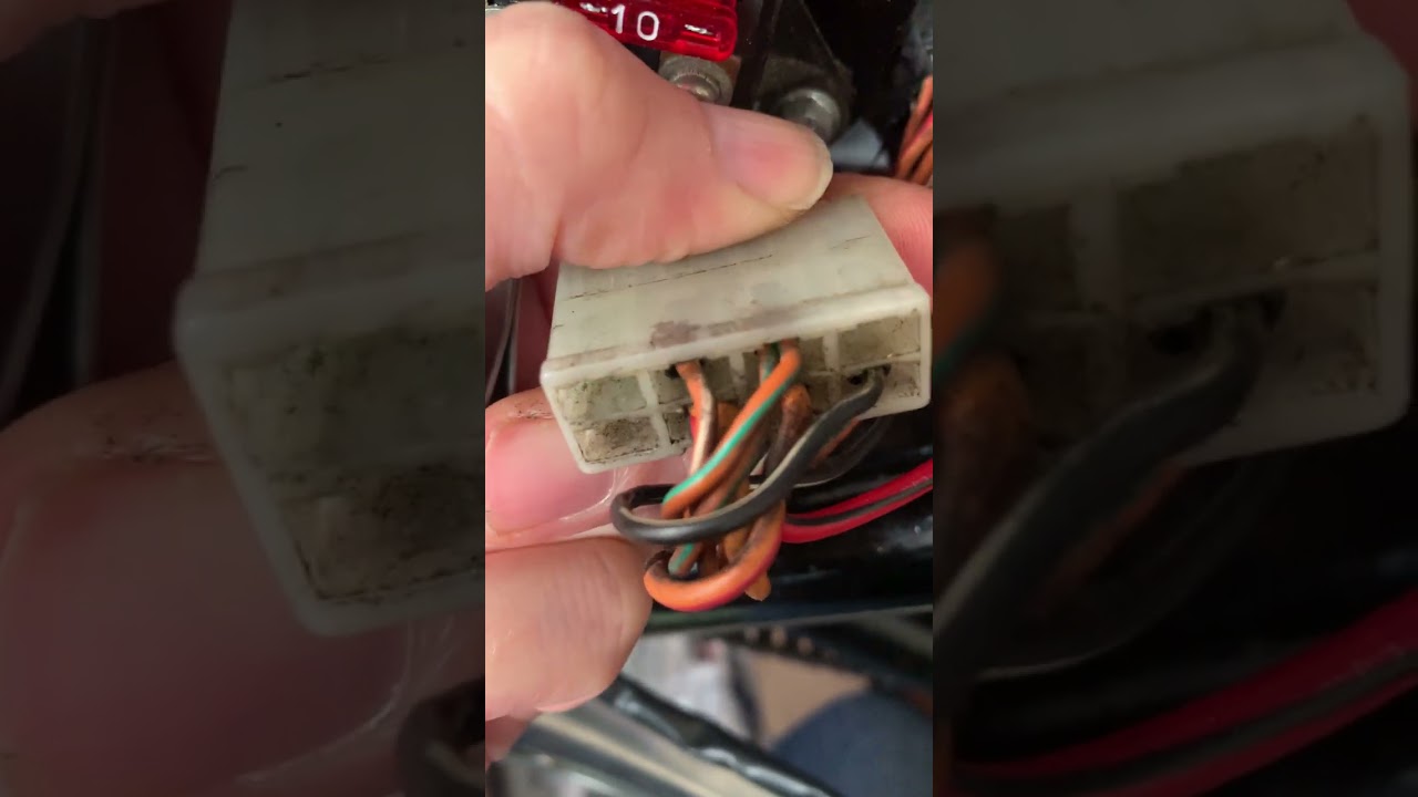

Point of clarification. My pics of a six (actually 8) pin connector are what is connected to the bottom of the fuse box and in no way should they be confused with what Sam had going into his SH555-12 RR. My confusion still lies in Sams pics seem to show no wires in this connector where mine show 2 reds.

Here it is…………….

Everything there looks same as mine, but your 2 empty slots on the right where I have 2 reds. If I get a chance tomorrow, I will trace them to where they go to/come from exactly, If I can do it without tearing everything apart. My Tiger is down at the moment, and the weather is just too nice to be without a bike.

Since your wiring has been modified by the PO, you don't necessarily need a red wire going to the fuse box.
The PO may have taken that 2nd red wire from your battery positive post, that went to a bullet connector down near the electrical panel, unplugged it, and connected it to the red wire that goes up to the ignition switch (since the + side of the ignition switch is hot all the time, even from the factory).
When the ignition switch is turned on, power comes back down the orange wire to power up the top three fuses of the fuse block. Where that orange wire enters the fuse box is where the PO picked up the sensing voltage for the old regulator. That way the sensing wire going into the old regulator is only powered up when the ignition key is on.
Since this is only a guess, so to verify, where does that 2nd wire from your battery + post end up?Jim, in Central New York State.
