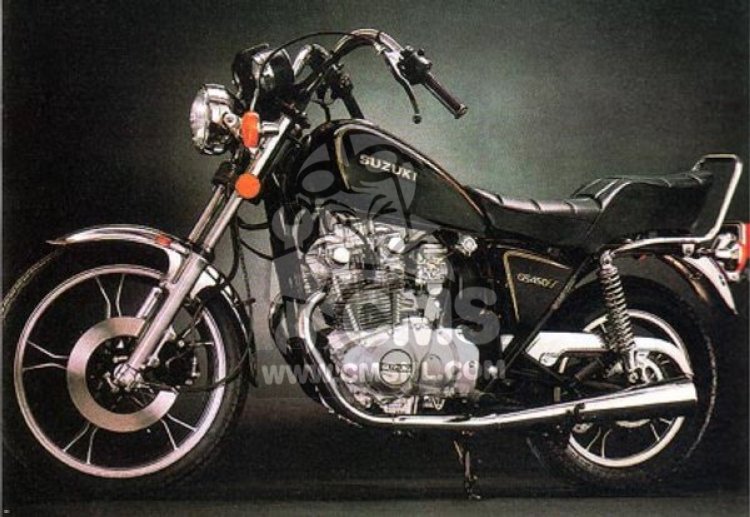

                          • samson
                            Also try here:
                            http://www.cmsnl.com/suzuki-gs450_model13427/
