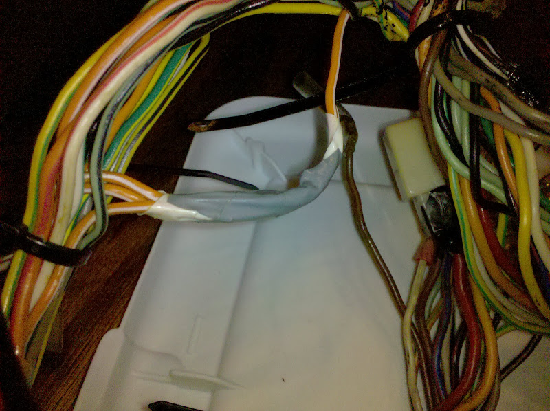

            The story of the harness
            In my quest to never again be stranded by electrical troubles, I decided to disassemble, clean and generally work over the wiring harness. I don't have any pics of the disassembly process, but it was wrapped in nasty, gooey tape. Yuck. I tried soaking it in high concentration of dish soap to get rid of the sticky residue, but that didn't work. A good soaking with WD-40 and a wipe down did.
            I bound the unwrapped harness with wire ties to mark the original splits, etc.

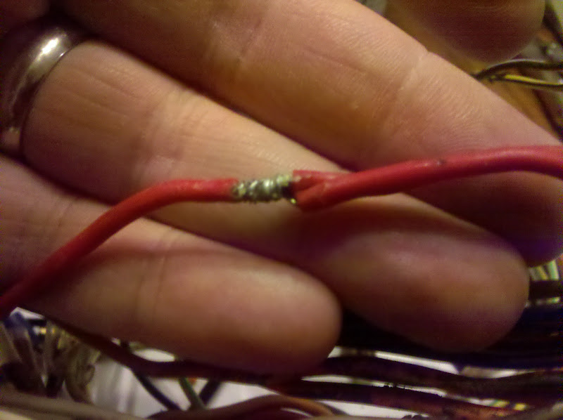

            as illustrated elsewhere. I then worked from end to end inspecting and replacing every splice and crimp. Since you can't visually inspect a crimp, I just cut them out and replaced them. The soldered splices were more interesting:
            Every one of them had two layers of electrical tape, each layer a different color. The different color tapes seemed to have no difference other than color. All of the soldered splices looked to be quality work: neatly wrapped, clean and shiny solder. Except this one:

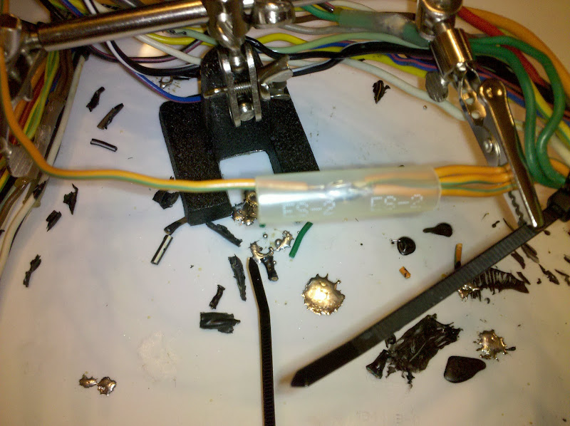

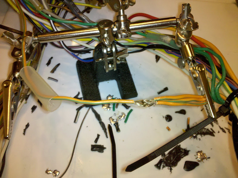

            Showing definite signs of corrosion, this is the infamous "somewhere in the harness" split from the regulator positive site to the battery and fuse panel. This is what Steve bypassed back in May to get it charging the first time.
            Somewhere in my researches, before starting work, I ran across a post by brwinger recommending double-walled heat-shrink tubing. This stuff is the bee's knees. $5 for 48" from McMaster Carr. The inner wall melts when headed, gluing and sealing the tube to the splice. Here's the process.
            Tie the bare wire together to make the mechanical bond. Notice the chunk of tubing already on the wire. Solder the splice, then forget to take a picture.
            Here's the tubing ready to shrink. The low setting on Harbor Freight's $10 heat gun was great for this.
            I should have used the real camera instead of the Droid, but here you can see the the melted inner layer of the tube squirting out the ends. This flow completely seals the splice. The transparent tubing allows you to visually inspect the splice at a later date. Very nice.
            All the connectors were cleaned with Deoxit, and protected with dielectric grease. I got the dielectric grease in a can this time, which is much better than the little blister packs you can get. I expect the can will be a lifetime supply for me. I didn't find the Deoxit locally. I'm sure somebody has it, but I'm not driving half an hour to some electrician's supply store on te other side of town. McMaster has it, but not as Deoxit. Deoxit's web site explains with numbers to order from McMaster. 8381T11 is it.

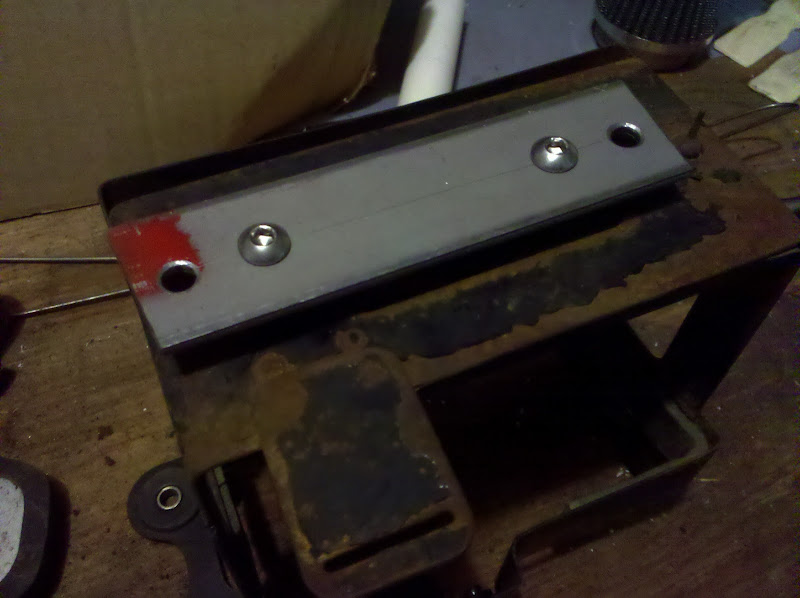

              As Duaneage has pointed out, the $40 Honda R/R is the most cost effective direct replacement for the GS unit. Unfortunately for me, I don't want a direct replacement. The shunt regulators all can cook a stator, and I'm not having that. So I bought the Cycle Electric 601. It's larger than the Compufire, but significantly cheaper with a bit more capacity (which the GS can't use anyway).
              Quite a lot larger than the stock R/R. However, it does fit in the space under the battery box on the GS shafties. At least on the T and X models.
              Here's the backside of the unit, and with the mounting plate removed:

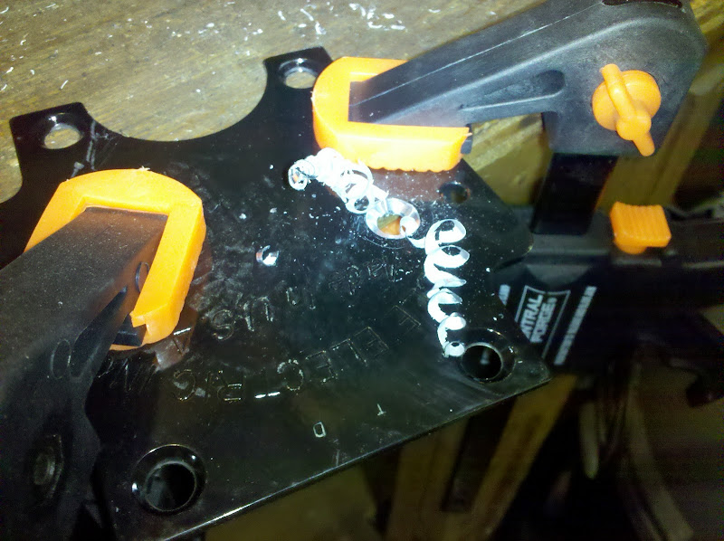

              Initially, was concerned that the new regulator was too heavy to mount on the battery box. After some consideration, I decided to try a simple adapter plate, and I'm happy with the installation, in principle. The implementation, not so much. I've done better work. Here's the adapter plate, and the battery box in dire need of de-rusting and painting:
              The cycle electric mounting plate needs clearance for the screw heads holding the adapter plate.
              I had some nice curls going when the drill's battery died. The mounting plate drills easily. I might have been able to drill it in one step instead of three.

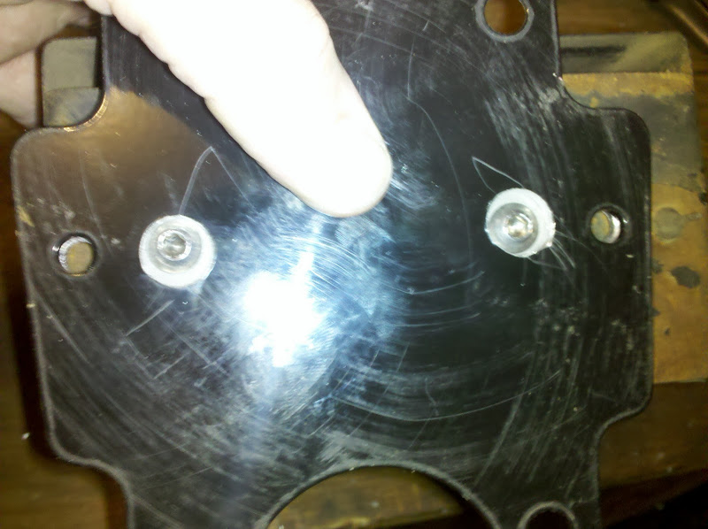

              Here you can see my sloppy work transferring hole locations:
              I think I may have transferred the holes to the wrong side of the adapter plate. Moot point. It fits. Notice the button head caps screws. These, or low head cap screws are necessary to make sure the screw heads clear the epoxy potting in the R/R. The adapter plate is 1/8" thick.

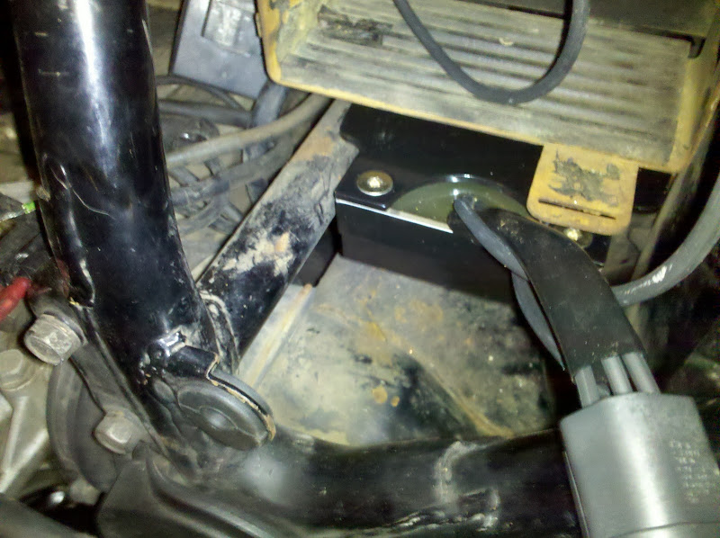

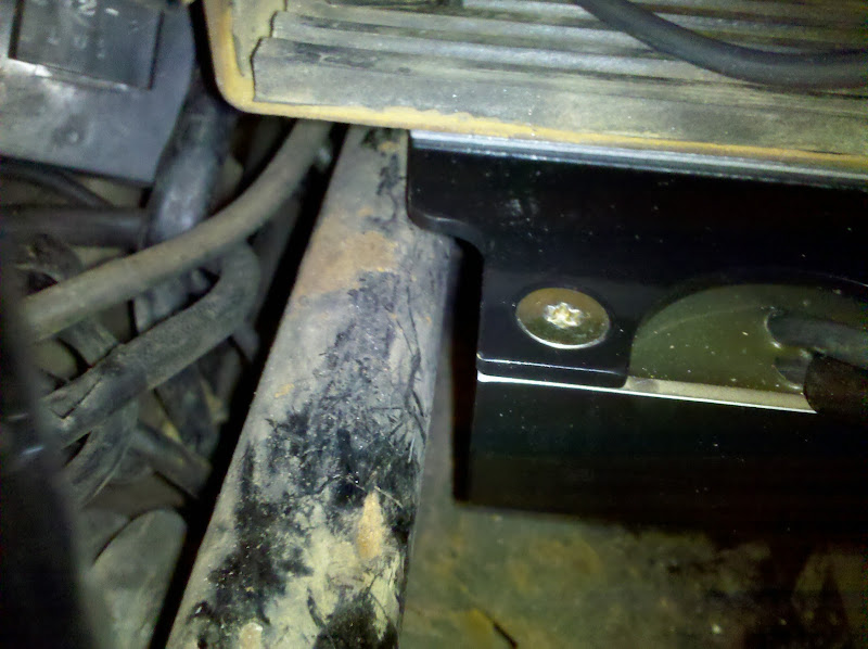

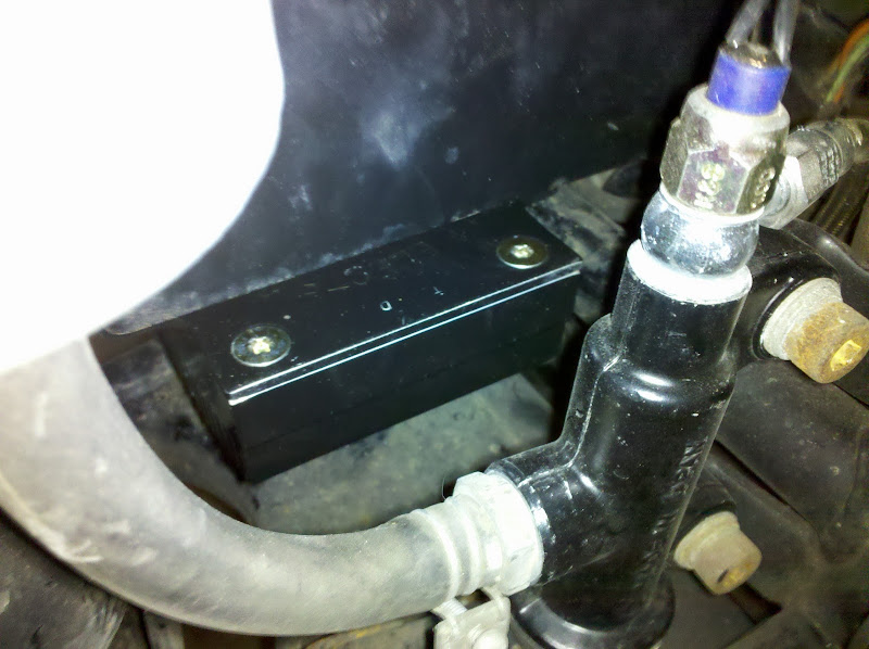

              Here are some pics of the regulator and battery box installed:
              A pretty snug fit. I would like to have positioned it a little farther from that frame tube, but it's also against the inner fender to the rear. Button head cap screws are necessary here also, to keep it from rubbing the frame.
              Not the prettiest installation, but not too awful, I suppose, for figuring out how to get it in there. Those who choose to follow this path can make it look good if they choose.

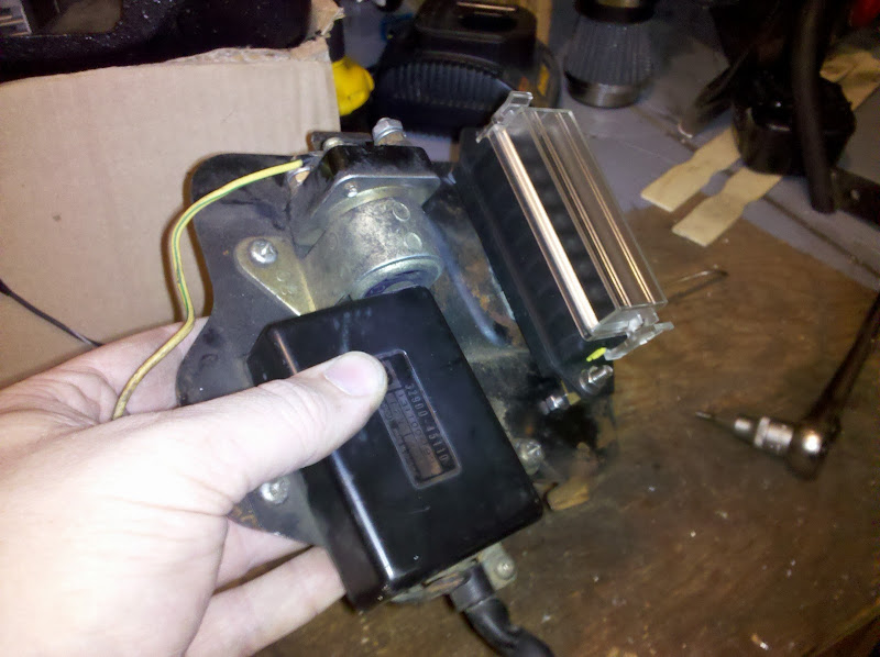

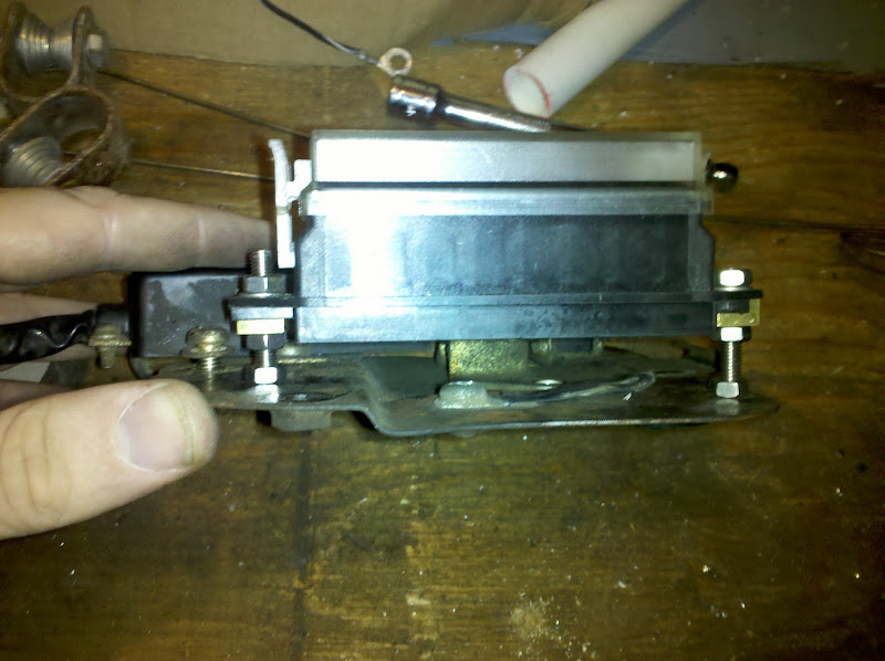

                The story of the new fuse panel
                In the process of inspecting the whole electrical system, I was delighted to find that the main fuse's holder was, in fact, broken. This wasn't helping things. So, I installed a new fuse panel. New OEM parts are not cheap, and they use the old glass tube fuses. Instead, I bought a cheap 8 position panel for the more moderns and available ATC fuses. You can even install breakers in the ATC form factor. I guess that would be handy if you expect to push things near the limit. With 8 positions available, I was able to add a fuse between the R/R and the battery, as well as a switched auxiliary circuit to complement the usual unswitched auxiliary. With one position to spare. Never mind that I don't need any auxiliary circuits just now.
                Here are some pics of the mounted fuse panel without much discussion or even good focus:
                The mechanical installation on this turned out pretty well. Just some stainless socket head cap screws with strategically placed nuts to elevate the panel and make room for the wiring.
                I like the gasketed cover on this panel. With the wiring into the back sealed with epoxy, there should be little trouble with corrosion. The electrical installation did not go nearly as well as the mechanical. It is so ugly, I'm not even going to show it to you. The ideas just didn't pan out the way I wanted. I intend to do it over. It is quite functional though, so it's staying in place for now.
