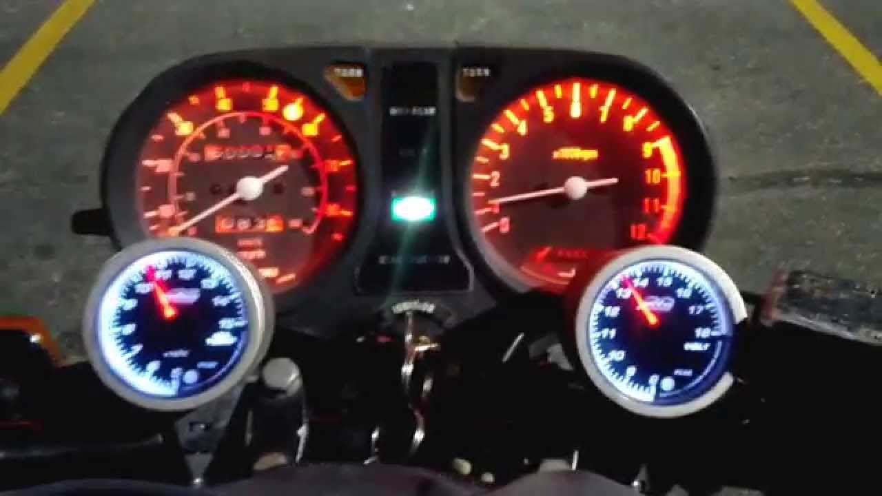

                              OK, it only took me four and a half years to get this done, but here it is. I added an oil temperature gauge because, well, I just wanted to, OK? Anyhow, I can think of a certain mountain in WV that got me thinking about oil temperature.
                              So the story is, I spent several months searching off and on for a way to mount the gauges in a way that I liked and pretty much came up dry. I got distracted by several other projects, including getting a 3D printer. In 2011, that was even less of a plug and play thing than it is now, so I forgot about the gauges. Later, Steve pointed out that the 3D printer should be the solution to the gauge problem. Well, duh. I started playing with some ideas, but still didn't find a solution I liked. Then, after swapping on new bars after my low side, I noticed an obvious solution while the handlebar pad was off. The mounts shown below are the 3rd iteration. I plan to tweak them a hair so I'm looking at them more directly. Fortunately, I don't need to print another set to get that done. They're on the curved part of the handlebar, so I can just move them over a bit and they'll turn inward.
                              Clearly, I am not a videographer.
                              GS charging system veterans will notice the odd regulator behavior. That's the Cycle Electric 601 series regulator. (Don't hang it from the stock mount) Rather amazingly, I wired these in at the same time I installed the SSPB, and it all works. Apparently, I can follow instructions occasionally.
                              Any suggestions on how to waterproof them?

                                Looks very nice. I like the way they blink and drop down after power down. Are they showing the max since last power on?
                                I had one of the cheap blue LCD units and it quit working after a few months and wasn't waterproof.
                                I've had a Shoe Chrome knock off for a little over a year as I like to have the temperature and time as well. I made a cheap plexiglass housing for it and velcro'd it right below my cluster. I have a CompuFire 55402 on that bike and the voltage on the cheap knock off bounces up and down a bit, but there is a red light that flashes if it goes over 15V.
                                Really like what you've done there, the matching oil pressure gauge is nice. Your 850 just tuned 60K eh? That's great!
                                Curious how you'll waterproof them as well.
