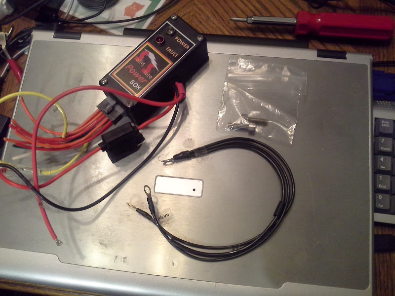

                      Jim,
                      Mine showed up in the mailbox today.
                        Mine arrived too. I like the labels.
                          Glad these things are arriving so fast. If you back the screws off about 1/4" then you can open the cover to see the jumpers.
