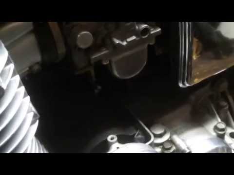

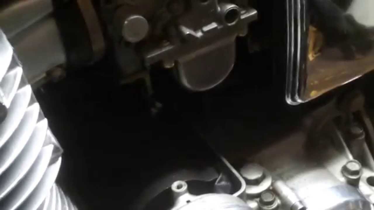

          Well I've replace and cleaned the starter relay, cleaned the fuse panel, checked the connections at the relay, starter, fuse box, etc..etc.. everything looks fine. Voltage to the starter relay is good, drops to 9.5V when trying to start but that's identical on my other bike and that thing starts amazingly quick. Here's a video of the sound.

            Video is private, Rob.

              Try the video again, seems there was one more thing I had to do to publish it.
              Rob
                To me it doesn't sound like the starter is turning the engine over at all. Pull a plug and see if you can tell if the pistons are going up and down. My bet is a starter clutch problem.

                  Sounds to me like it's cranking slowly, but it also sounds like it's got no compression.
                  Did the cam chain jump a tooth or three?
                    Are you sure the engine is turning over? It doesn't actually sound all that "slow". I have one foot in the starter clutch camp.
                    '83 GS650G
                      Good video.
                      Sounds like starter motor turning something, and something is putting a load on the starter motor (isn't just spinning freely like is just the starter motor out on a bench connected to nothing), but engine crank not turning (pistons not going up and down). COuld verify that by listning more at end of exhaust, or by removing a plug to hear if air blowing out and sucking in.
                      Sounds like starter motor is turning, and probably turning the starter clutch, but starter clutch not turning engine, starter clutch grabbing some but not turning engine.

                              That's a pretty funny video indeed. I'm going to pull the stator cover off this weekend and see what's going on in there. Something has obviously come loose/broken. Someone questioned the cam chain but it's fine because when the bike does start it runs perfectly and I have been into the cams last week checking the valve clearances and everything was fine. Thanks for all your input everyone, I felt it was in starter clutch as well but I wanted to get a consensuses before I pull the stator cover and have to order another gasket. It's weird though, since I was last into the starter clutch/rotor I've put probably 6000km or more on the bike with no issues, I'll be interested to see what has given.
