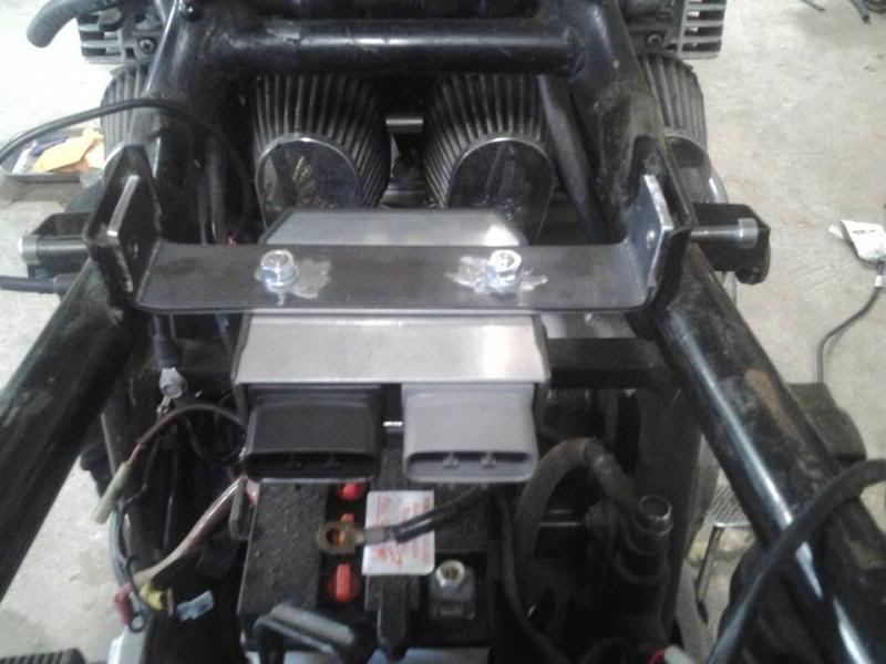

          Blatant copy of Tom203's idea for under the tank for my 82 1100EZ. I am running pods, so no airbox. This mount needs some rubber bushings of some sort for vibration damping.

            Here is the solution I will probably end up using: I just flipped the R/R upside down and mounted it on the back side of the electrics mounting plate using the factory R/R mounting holes. Hopefully, some time in the next couple weeks as the temps finally start dropping here & the rain subsides, I'll get back into the garage and get the wiring harness installed and get some better photos....
            Hope these are helpful!
