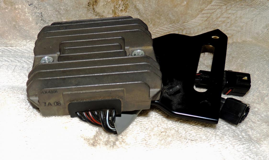

Can anyone ID this r/r. Also some help with this 7 wire installation - three black wires - two black with red stripe - two black with white stripe. Any help much appriciated. Thanks

I have a 7 wire r/r ready to install into the 1979 GS1000 project. I picked this up on ebay a few years ago but forgot the original application. Think it was a Honda GW - not sure??

IF one were a gambler, one might speculate that it COULD be very similar to a 7-amp 2008 Rectifier/Regulator knock-off from China, very similar to the link below.
The color codes on the wires do not match your image on the epoxied heat sink, perhaps the connectors are wired correctly, scroll down the page for images...
http://www.aliexpress.com/store/prod...003871594.html

Probably a shunt type RR to boot.sigpicMrBill Been a GSR member on and off since April 2002
