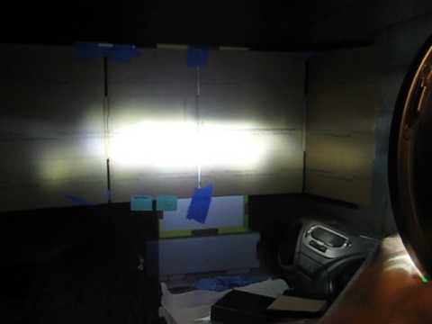

        Here is a video showing the effect of focusing your LED Drop bulb-in by adjusting the depth into the reflector. Certainly worth playing with a bit before completing your install. At least on this reflector, the cutoff seems to be improved and there is a reduction in spill over to the driver's side.

        I tried to optimize the Lo beam cutoff of the Halogen; did no good. It just seemed to get worse as I pulled it back. After focusing the Cyclops 3800 had a noticeably better cutoff than the Halogen.

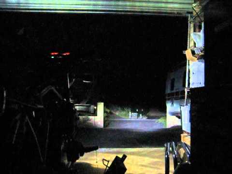

                        Daylight review
                        I should mention this was late at night and I forgot to put the camera on manual. So the distant changes in light between high and low beam are at least 50% more from what you see in the video. The close in flood lamp is probably about right.
                        It is also interesting to look at the side of the motorhome, as it shows pretty clearly the effect of the cutoff and the change in dip angle as the Cyclops is switched between Low and Hi.
                        The video is taken with the camera in the dark taken from behind the bike with a distance of about 7ft from camera to headlamp. I start in Lo beam and then switch a couple time between Lo and Hi. returning to Lo beam, I then switch the 18W Work light on and Off where you will notice the increase in lighting directly in front of the bike. Finally all three are turned on.
                        None of the beams was actually adjusted except that the Cyclops had been previously focused using the PVC spacer.I popped the bulb out of my spare lense and into the lens on the bike.
                        This video is of the Cyclops 3800 with both Low and High beam (40 watts rated/32Watts measured) as well as a work light I got off of Amazon ( 18W rated/12W measured). The flood light is used as a close in driving/fog light with a 30 degree flood pattern for close in. I have it controlled by a left hand switch push button. I have played with a cutoff for it but the video is the unshielded lamp which adds substantially I think.
