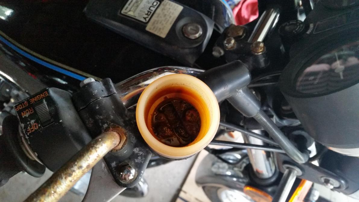

I tried hard but I can't find the right 'smilie' to go with that picture. But now I'm pretty sure that the return hole is blocked. :)
You might still be able to save it. At least it's had fluid in it and hasn't dried out. Take it off, strip it down, use lots of brake cleaner spray and see what you can see.
If you have access to a small ultra-sonic cleaner that would help a lot.
Still in liquid form is a bonus. haha.
Usually has a nice aroma too.
Just a tip, when working with the brakes, put a towel over your tank for protection. It can damage the paint if spilled.
Right in the middle of that mess is a little cover tab that I guess is to keep crud from blocking the tiny return hole under it in the reservoir. I suppose you will break it like I did attempting to clean it and end up ordering a new reservoir along with the rebuild kit. If I remember correctly that plastic gets a bit brittle. There should always be a little slack in the brake line before it activates the brakes (about 1/4"). You have experienced what happens when there is none.

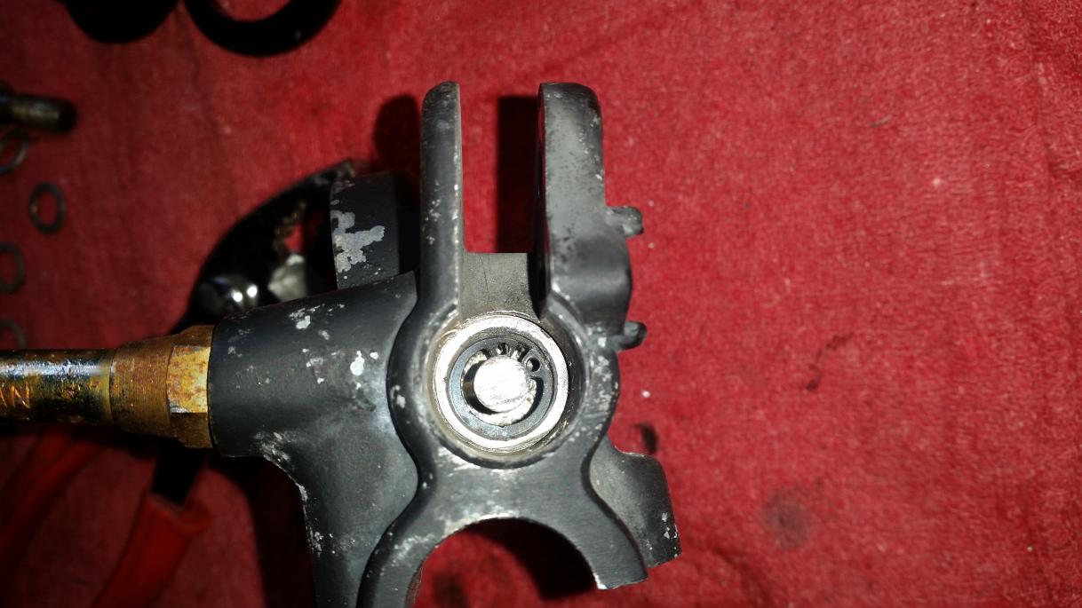

Getting the snap ring out of the master cylinder to remove the piston is proving to be a lot harder than any of the youtube videos made it look. I bought a snap ring pliers but of course it won't fit in to the cylinder far enough to actually use it. I was able to get a little movement using a couple long screws and the rage of a thousand suns, but now it's stuck. Am I going to end up having to spend money on the entire master cylinder enclosure or is there some way to get this out that I just can't see?

Thanks, those look like they could work. I'll have to order some if I can't find someone locally that has a pair.
A cheaper method is grinding down the points of a set of needle nose pliers.
Start with a set with long, slim jaws. They are usually fairly cheap at Harbour Freight.
Once I got another set of hands involved I was able to get the clip out using a couple of stronger picks. Used an air compressor to pop the stuck piston out of the caliper. Still in process of cleaning everything as good as I can, but now i'm just waiting for all the replacement plastic bits and the master cylinder piston and I'll get it all put back together. A huge thanks to all that chimed in here, it was a huge help.
