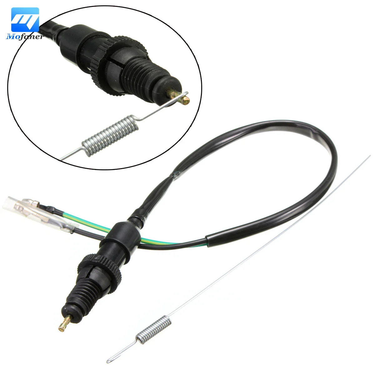

                This is what it turned out to be, light was always on.
                The problem turned out to be the rear switch which I hadn't touched, coincidence I guess.
                A new spring will fix the problem.

                  If it's always on then you just need to adjust it so it's not being pulled till you push down on the pedal. Don't turn the switch itself, pop it out of the bracket and turn the part that holds it in the bracket.

                    That's it alright.
                    My spring is too short, keeps switch in on position at all time, even with shortest adjustment.
