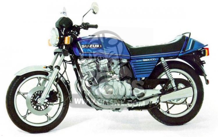

              This is great, I'll look into the valves. I actually have no idea if my bike is an L or E, the owner just knew it was a GS400. Can you tell by the photo what the bike is?
              Here's a photo:
                From that photo, it's an E.

                  Looks to be a T, but the vin ticket on the steering head should give you the info. I didn't think they made the T until '82, but Ts are a bit scarce and maybe I haven't seen an '81 yet. The '82s often have a build date from late '81. The wheels should be 17" rear and 19" front but they interchange and it looks like your front might be an 18" or the fender is from something else.
                      It's an 81 T. I have one.Registered as 81 and per the VIN 10th letter is B and per the wheel rims too.
                      but they moved some bolt holes around in '83 as I recall
                      yes they did change the valve cover. Again, I have one. perhaps change is co-incident with the newer tubeless rims..

                        There is much confusion partwise as your GSX is called a GS400 in Canada, but unknown in 99% of the US catalogues where they got a GS450 instead.
