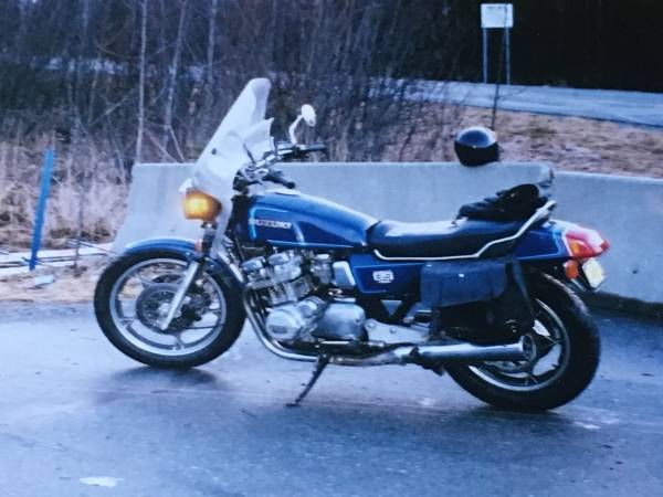

    Here's the pic the seller had in his Craigslist ad from 04' when he first bought it....I'll post a pic of it as I went and looked at it, there was a difference in appearance but its cleaning up quite nicely.

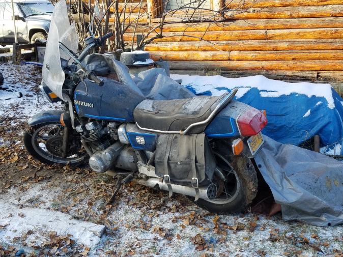

    How it looked under the tarp...fuel tank is a third full and clean as a whistle inside although the petcock is stuck in on position. Surprisingly tires held air and are still up 3 weeks later.
