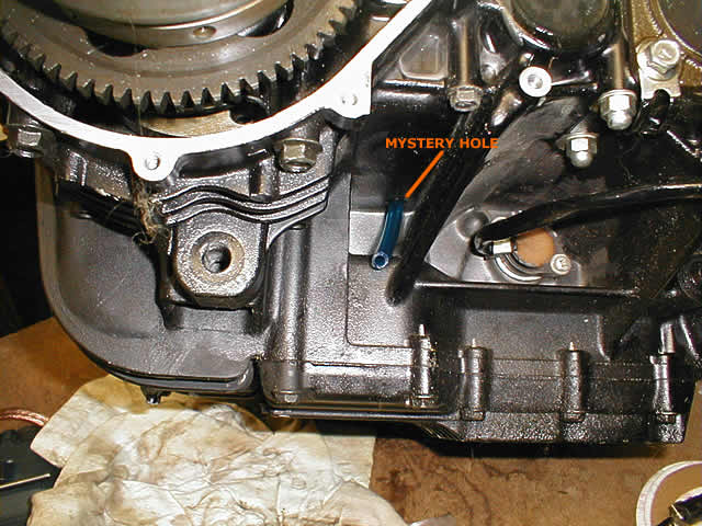

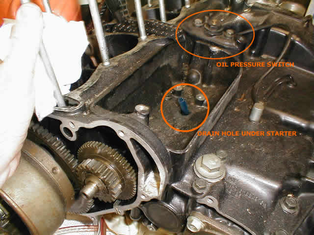

            Hard to tell in the rubble here, but I've seen a starter filled with similar-looking corrosion after some ignorant dipstick spotted the Mystery Hole on his GS and plugged it with epoxy.
            The Mystery Hole is a drain for the starter cavity, so if you plug it the starter eventually ends up sitting in a pool of filthy rain water. This cavity is not sealed from the elements; it's designed so that water will make its way in to this area, but then drain out harmlessly.
            I dubbed it the Mystery Hole a while back because it became a regular thing for new GS-ers rummaging around under their engines to absolutely PANIC when they spotted the GIANT HOLE in the ENGINE!?!?!?!?!?! And if they had an oil leak from the starter o-ring and/or cam chain tensioner, the oil would eventually make its way out the Mystery Hole, creating DEFCON 1 levels of panic and dismay.
            Here's a view of the Mystery Hole on a junk engine. The blue tubing is only there to show these are connected:
