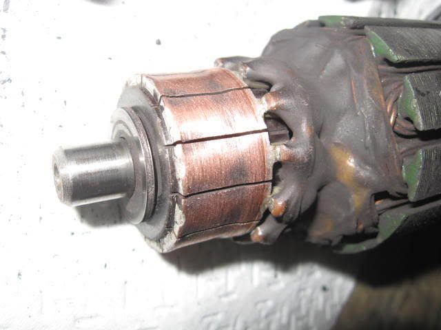

          Here on mine, in 2008, the brushes were worn so short that wasnt much spring pressure, and the commutator bars had a lot of brush dust melted into them. And Just would not go most of the time, and when it did it was slow.
          Here is after I cleaned up the commutator bars. I had glued some emery cloth to a paint stick to use like a file, and then spun the rotor in a drill motor.
          Has been good since.
