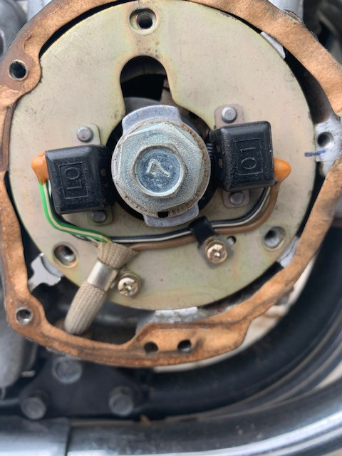

    You want the Dyna S......but you need to determine if you have the stock ND or KD ignitor setup...look for markings on ignitor box and/or signal coil plate

      Tom, did they have different ignitor setups? I know they had different points systems, but I have been under the (possibly mis-guided) impression that all the electronic systems were the same.
      Pappy, while the Dyna is a good system, you might not need it. Do a bit of troubleshooting first to determine the cause of the failure. It might be as simple as a loose connector or broken wire between the signal generators, ignitor and coils. Since it is #1 and #4 that failed, it would be related to the coil on the left side of the bike.
        He's likely got the ND setup...but best to check.

                Okay...started with the signal generators. Ohmed them out and they were both around 65 ohms so both are well below what they should be.
                This sort of makes sense as what spark I normally have is very weak at best. I checked spark on 2 and 3 and it is there but barely visible.
                Put the connector back together and decided to try it. Bike fired up on two cylinders and eventually the other two kicked in with a lot of come and go as far as ignition goes so am assuming the coils are good as far as connections go.
                It is my understanding that the 1981 model should have points anyway? Since I do not know the history of this bike it may have a later engine in it....not sure.
