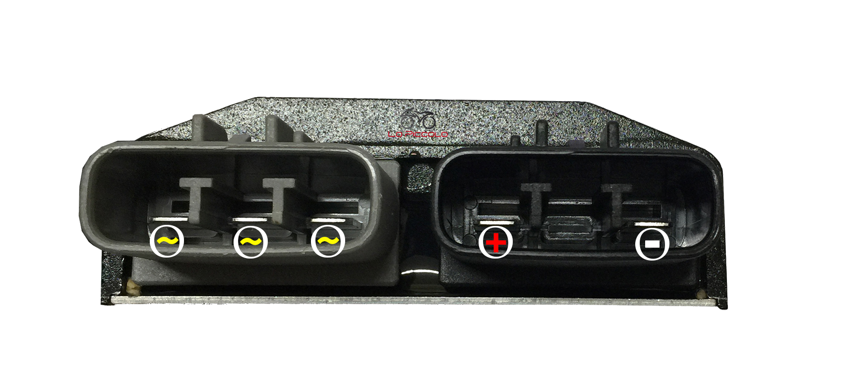

The new r/r was delivered today. Trying to identify positive a ground wire. Uploaded photos with what I think it is. Am I correct? And is the G•H and 3•1 that I have circled indicating otherwise? IMG_20200430_210416859~2.jpg1982 GS1100gl
Or is this saying Ground and Hot is on left side and stator goes to right? Even though left side has 3 terminals and right side has 2IMG_20200430_210422430~2.jpg1982 GS1100gl

Google "sh775", click "images"...

Originally posted by jknappsax View PostAnd being a switching reg rather than a shunt, the bike should run cooler.Ed
