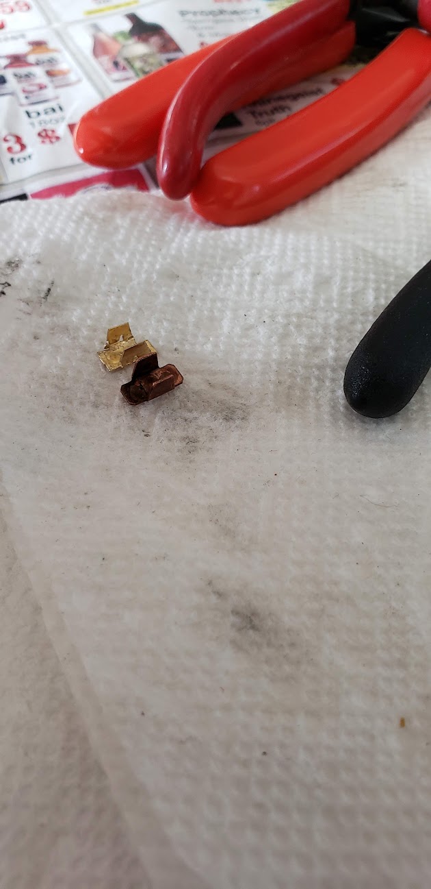

And I'm thinking maybe, just mayyyybe I can fashion a copper contact for the other side of the switch with some careful bending of some bullet connectors I have laying around. Thinking I can flatten it out, do some careful bending and maybe get something going? But I'm still not sure if it is even supposed to be there
Edit -
Turns out a female bullet connector is pretty close to the right size with a little bending and cutting. We'll see if this works when I get my springs in the mail lol
