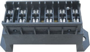

    Looking for links/recommendations for replacement blade fuse box for my 82 850 gl.

    I recently bought one locally from here...
    Blade Fuse Box / 6 Way Bottom Entry Suits FU2 Fuses Complete with clear cover
    It's bottom entry and sidesteps the usual problem that most of them have, of exposed terminals.
    I see that one's sold out, but they still have a 4-way version...
    Blade Fuse Box / 4 Way Bottom Entry Suits FU2 fuses Complete with clear cover Pack of 1
    Or, a side-terminal 6-way...
    Blade Fuse Box Side Entry 4, 6, 8 Way boxes available Please choose type required when ordering Pack of 1

        It’s a little pricey but You can’t go wrong with an Eastern Beaver box
          Got one of these on my GS1000. good quality for the price, more fuses than you need so you can add extra circuits if required, and a single point ground, which is key to healthy electrics on the GS's.

              I have one on both of the 550s in my garage and love them. Very little maintenance involved and with the relay in the mix they work great
