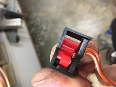

Didn't expect much result as I've not put much into it , but did pull this cover and I don't find much on this Japan Ignition system.
What am I looking at here (other than the right side of my bike)

You are looking at the ignition pickup for the electrical mic ignition, what used to be contact points (prior to 1980).http://webpages.charter.net/ddvrnr/GS850_1100_Emblems.jpg
